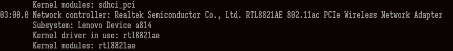

Cropped output from lspci -k

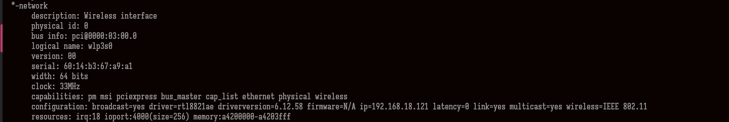

Cropped output from sudo lshw -c network

Why do you think you don’t have firmware for this device? NixOS installs redistributable firmware by default, which includes everything from linux-firmware, including the file your card’s driver seems to load.
Your messages show a device that has a driver loaded properly, and don’t say anything about firmware.

I believe there is no firmware as in the second image, it shows firmware=N/A, which I don’t really know how to interpret, but from previous trawling across other posts, it seems it should probably not say N/A.

dmesg is the command to run if you want to see kernel messages. It will tell you if something hardware related is broken, and the first place to look if you’re suspecting firmware issues.
I think the n/a display could mean a number of things, most likely it’s harmless (e.g. the device doesn’t report a firmware version). You’ll want to check the kernel messages to see if anything is actually wrong.

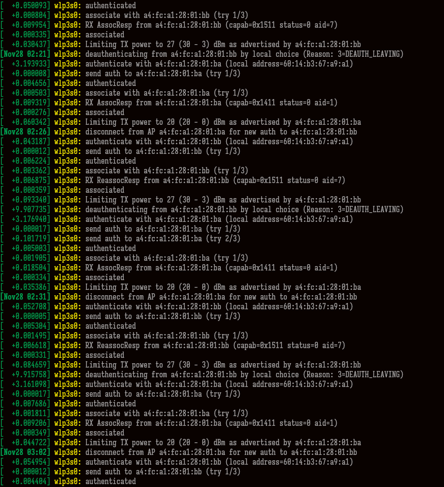

Thank you for the information. I’ve looked at dmesg’s output and it seems that the n/a is probably a red herring:
Screenshot from 2025-11-29 18-33-21

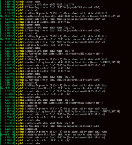

I actually did decide to scroll a bit more and did find this seemingly never-ending list of messages:
This is from yesterday. It loops like this for a while and seems pretty suspicious, but I have no idea what it means or how to interpret it.

Yep, nothing looks explicitly problematic as far as networking goes in your configuration.
That said, those messages look like the signal drops regularly, or some other very non-software issue. It might be that you’re using a very congested channel or something.
