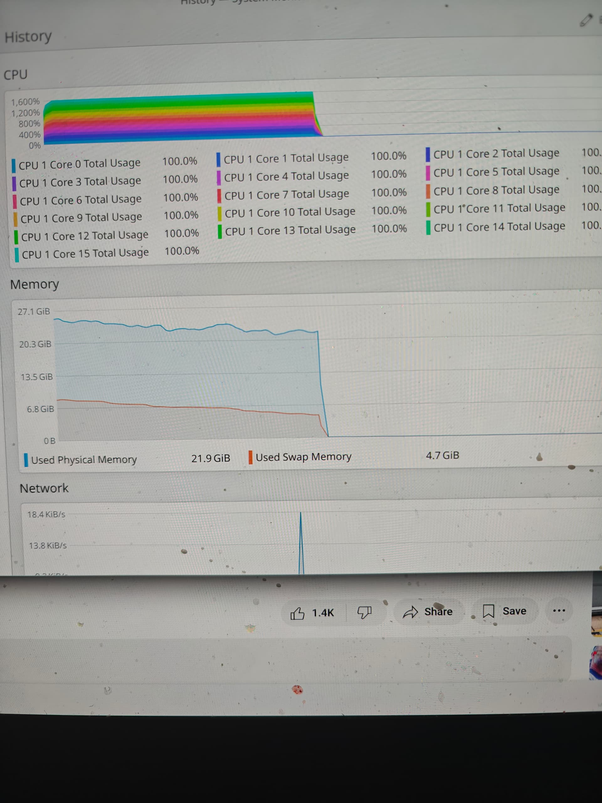

When rebuilding, Nix downloads pre-built packages, and if pre-built downloads are not available, then it builds them on your computer, which is probably what’s causing 100% CPU usage. You can avoid this by checking your config and finding if you added things which do not have binary cache. If you can’t avoid building the packages, you can also configure Nix to only use X amount of cores and build X amount of packages at a time, so you could make it so that only 1 core is 100% and not all 16 (but idk how much that will help with fan noise and power consumption).
Can you please tell me how to do that? 1 core might take too long so I wanna use half the cores. I just want to be able to use my laptop while it’s buildings. The freezing is unacceptable

Yeah, no, this is definitely memory pressure, the device getting hot won’t affect performance anywhere near as much as literally eating all available memory, it looks like both swap space and main memory are at capacity in that screenshot. Little memory use tweaks won’t help here, you’re just scheduling way too many builds.
If your configuration correctly uses the cache, you should never get into this situation.
If it doesn’t use it correctly, this likely means you’re also not getting updates at the schedule you intend, and potentially not at all in the future. You’re also still going to waste hours on builds you don’t need to do even if you reduce build concurrency, fixing what you did to not be able to use the cache should be your main priority.
This usually means you’re using the wrong channel or cargo culted a way of pinning nixpkgs that ends up pulling in a branch that isn’t built by hydra. You’ll have to share your channels or code for help fixing that.
Yes my memory (32GB) and swap (8GB) get used up 100%. I even tried increasing my swap to 32GB, it still used everything all up and froze.
