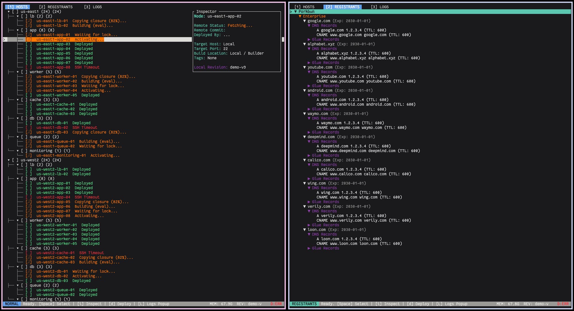

It’s a specialized deployment tool for NixOS, forked from Colmena. It extends the core deployment capabilities you might be used to with a persistent daemon architecture, integrated infrastructure provisioning via Terraform/Terranix, and a terminal user interface (TUI) for managing large-scale fleets.
It looks something like this:

  • TUI Dashboard: Launch navi tui for real-time fleet management, live monitoring, and interactive deployments.
  • Infrastructure Provisioning: Define Terraform resources alongside NixOS configurations in the same Hive, and manage lifecycle commands directly (navi provision).
  • Daemon Architecture: A background service manages connections and task queues (i.e. deploy in the background).
  • Disk Unlocking: Remote unlocking for encrypted ZFS pools via initrd SSH.
  • Provenance: Answers questions such as “what is outdated”, “who did this” and “what commit is this host currently on”.
  • Registrant support: Because it’s annoying that I have to touch HTTP just to deal with my domains.
