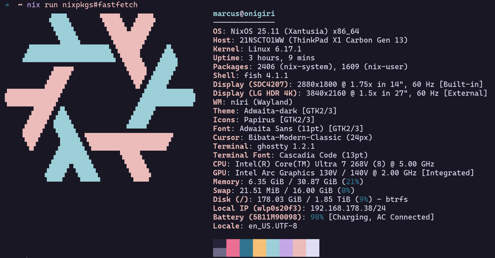

I don’t think my comment will help you but anyway. I am also using a X1 Gen 13, running wayland with the Niri compositor (which I really love). This is my actual settings:
Output "Samsung Display Corp. ATNA40HQ02-0  Unknown" (eDP-1)
  Current mode: 2880x1800 @ 60.000 Hz (preferred)
  Variable refresh rate: supported, disabled
  Physical size: 300x190 mm
  Logical position: 2560, 0
  Logical size: 1645x1028
  Scale: 1.75
  Transform: normal
  Available modes:
    2880x1800@60.000 (current, preferred)
    2880x1800@120.000
I am so happy with this laptop because everything works out of the box (sounds like an advertisement). The only issue I have, is that wake from sleep brings up the screen brightness to max. So everytime I unlock or boot the laptop, I have to bring down the brightness of the screen manually (end of advertisement) :wink:

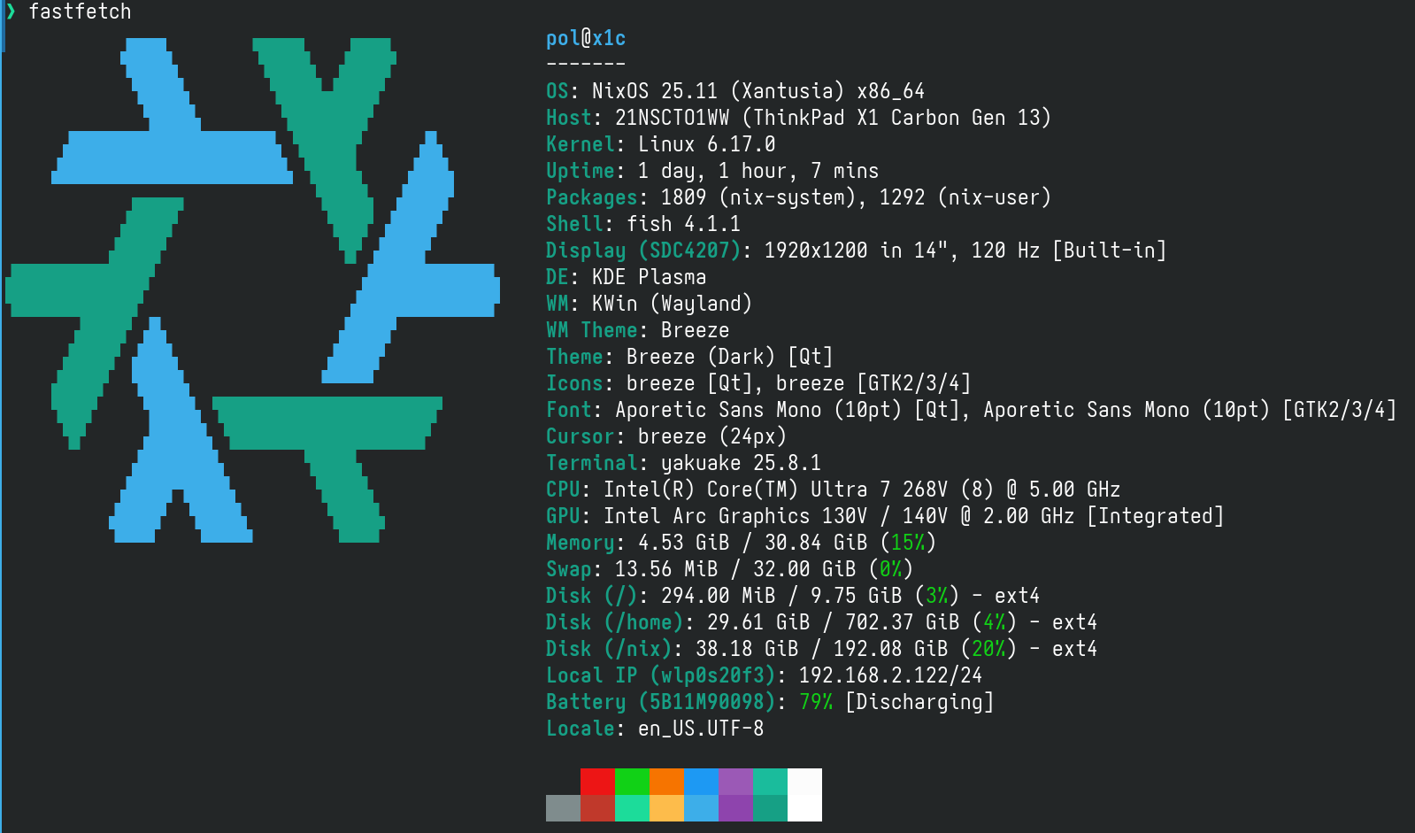

Hello,
I just received my X1 Carbon Gen13 with a Lunar Lake CPU. I’m super happy of it, what a nice device (yes, a bit expensive!!!) !

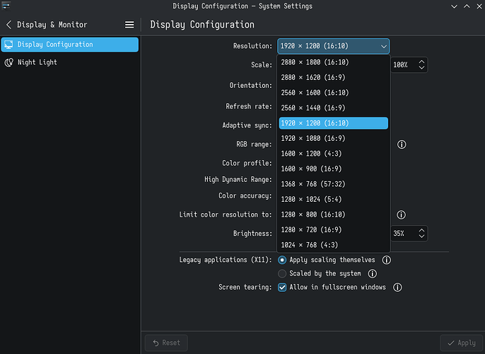

In KDE, I can have to all the resolution, as shown in this screenshot:
You can find the laptop config here: infra/modules/hosts/x1c at master · drupol/infra · GitHub
The only think I had is that I had to use Kernel >= 6.17.0 because there was a bug in the latest kernel 6.16.
Hope this helps!

I can just confirm the problem: I just recently got mine (w/Lunar Lake), updated System BIOS to 1.19, made a clean NixOS 25.05 install with KDE plasma and linux 6.17.3. Then updated to 6.17.4 with the aforementioned hardware-profile.
  • I have access to a long array of different resolutions, and 120hz refresh rate for the native one only; this screen is awesome; can confirm 200% scaling works fine, but apparently for native wayland applications only; legacy X11 and some tray icons, on the other hand, do not.
  • Enabling the “Scaled by the system” option makes then look very grainy.
  • Moving to 1920x1200 improves size overall, and a 125% scaling is mostly fine; however, refresh rate is only available on 60 hz on this setting. The loss of smoothness is very noticeable.
