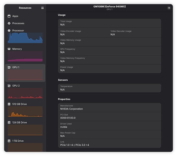

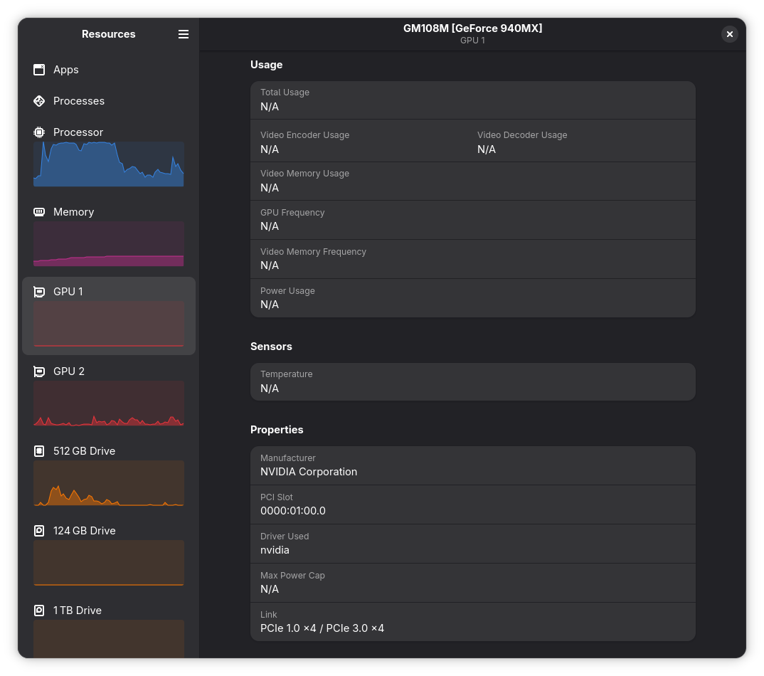

I try this but it doesn’t work :frowning:
Alright, what does “doesn’t work” mean exactly?
Besides explaining the outcome a bit better, can you log into a tty (press ctrl+alt+F3 instead of logging into your graphical DM), and share the output of sudo dmesg and sudo journaltctl --boot -e?
