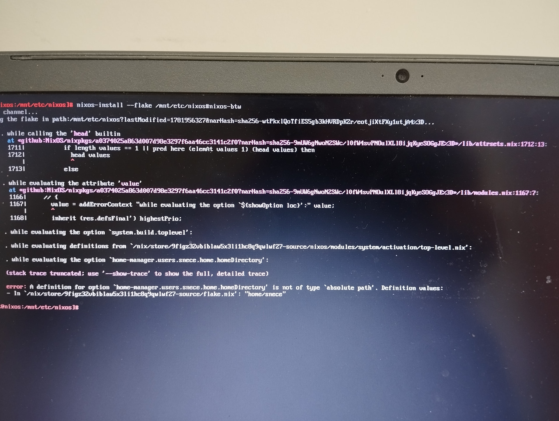

I dont even know how to describe this error. Heres an image:
Add a / to the beginning of your home.homeDirectory setting, whether you set that in the NixOS or home-manager module.
If you can’t figure it out, share your code (in text format, use a pastebin you can submit to with curl).
It seems like it worked, hold on.
Yep, no more errors. Thank you so much! Its my first time installing an OS from liveISO

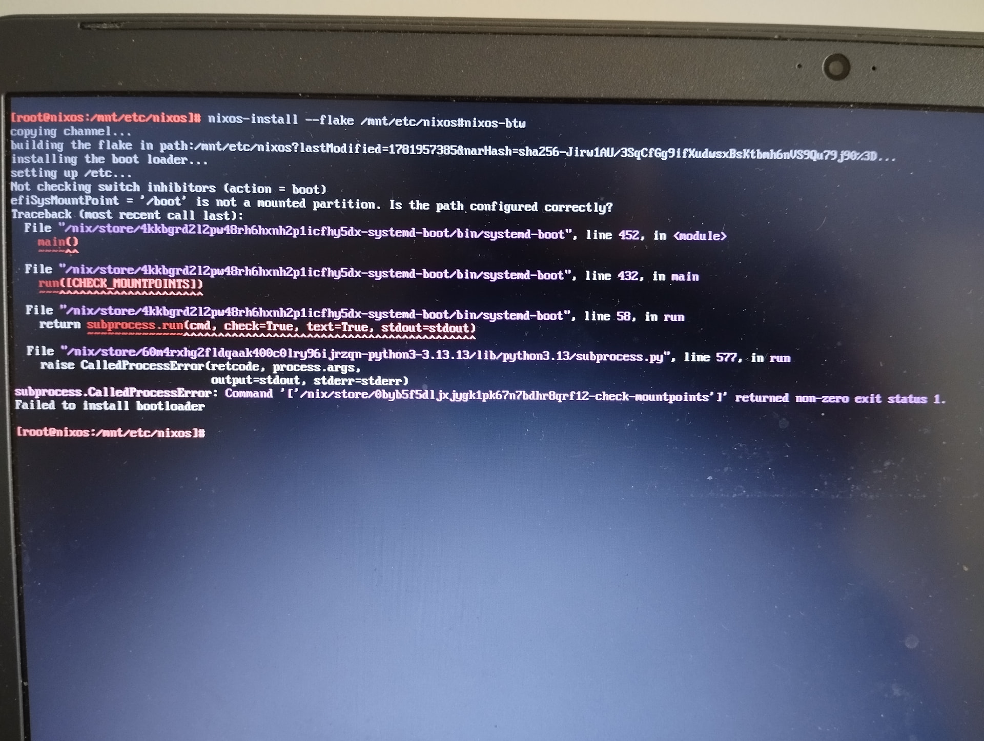

I mounted the boot partition on mtn/boot…
