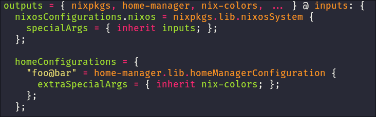

here’s how i did it:
I add the repo to my flake inputs.
2024-11-18_11-41-05
and that
then, I add that to my home.nix in /Flake/hosts/
2024-11-18_11-42-50

Post your entire flake.nix. Because right now it looks like you just copies the example from nix-colors, as I’m assuming foo@bar isn’t your hostname.
flake.nix
Are you using standalone HM or HM as a NixOS module?
PS nix-colors is pointless as all it does is set _module.args, which you can just do yourself.

You are passing inputs to your NixOS modules, but only nix-colors to Home Manager.
 imports = [
   ./../homeManagerModules
-  inputs.nix-colors.homeManagerModules.default
+  nix-colors.homeManagerModules.default
Well they didn’t even answer the question, of whether they’re even using standalone HM or not, and the HM configuration is literally named foo@bar which is of course incorrect, which is why I asked in the first place if they’re using it at all

You need to declare where the NixOS and Home Manager configurations are located:
nixosConfigurations.nixos = nixpkgs.lib.nixosSystem {
  specialArgs = { inherit inputs; };
  # Here:
  modules = [
    ./path/to/configuration.nix
homeConfigurations."foo@bar" = home-manager.lib.homeManagerConfiguration {
  extraSpecialArgs = { inherit nix-colors; };
  # And here:
  modules = [
    ./path/to/home.nix
