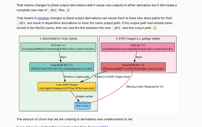

This behavior has always felt sketchy to me because there’s no evidence that the “recipe” of the derivation even really produces the fixed output.
It’s always felt like each derivation referencing the output should need to get built somewhere and at least a signed “note” added to the store that this derivation really does produce this fixed output.
You seem to be thinking more like CA derivations than the usual FOD.
The amount of churn that we are creating in derivations was unbeknownst to me.
It’s not really “churn” - if the derivation must change because the inputs changed?

When calculating the outPath for a derivation we already replace out FOD with their outPath in the drv so that the path doesn’t change needlessly. (This is what gives FOD super powers for not doing mass rebuilds).
For all other inputs to a derivation the .drv path is used in the calculation of the outPath.
Now the thing I wanted to highlight, is that .drv themselves have an outPath.
(The path of the .drv file itself not the produced artifact)
This path is usually calculated as a content-addressed hash so it changes depending on all inputs which I tried to demonstrate in my blog. This causes a lot of drv “churn”.
I was contemplating, could we not also replace the inputDrvs when calculating the store path of the .drv file itself also to avoid churn.
(I suspect yes)
I added a new graph to the blog to help (I hope – feedback welcome)
Yes! Almost like a weaker form of CA derivations in terms of the exposed interface (but the details of the build process would be pretty different).
