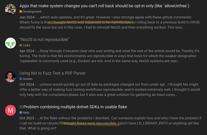

Yeah, they really do, and they think it means that deployments, including all state can be repeated across systems, because a Youtuber told them nix was magic. Which makes sense, because frankly, most people (including most nixpkgs contributors) outside of say, research-related or security-conscious fields, don’t really care about bit-for-bit reproducibility nor find it useful. (I’d even say it’s not a priority for NixOS in general, since even our minimal ISO has mostly been non-reproducible over the last 2-3 years at least.)
