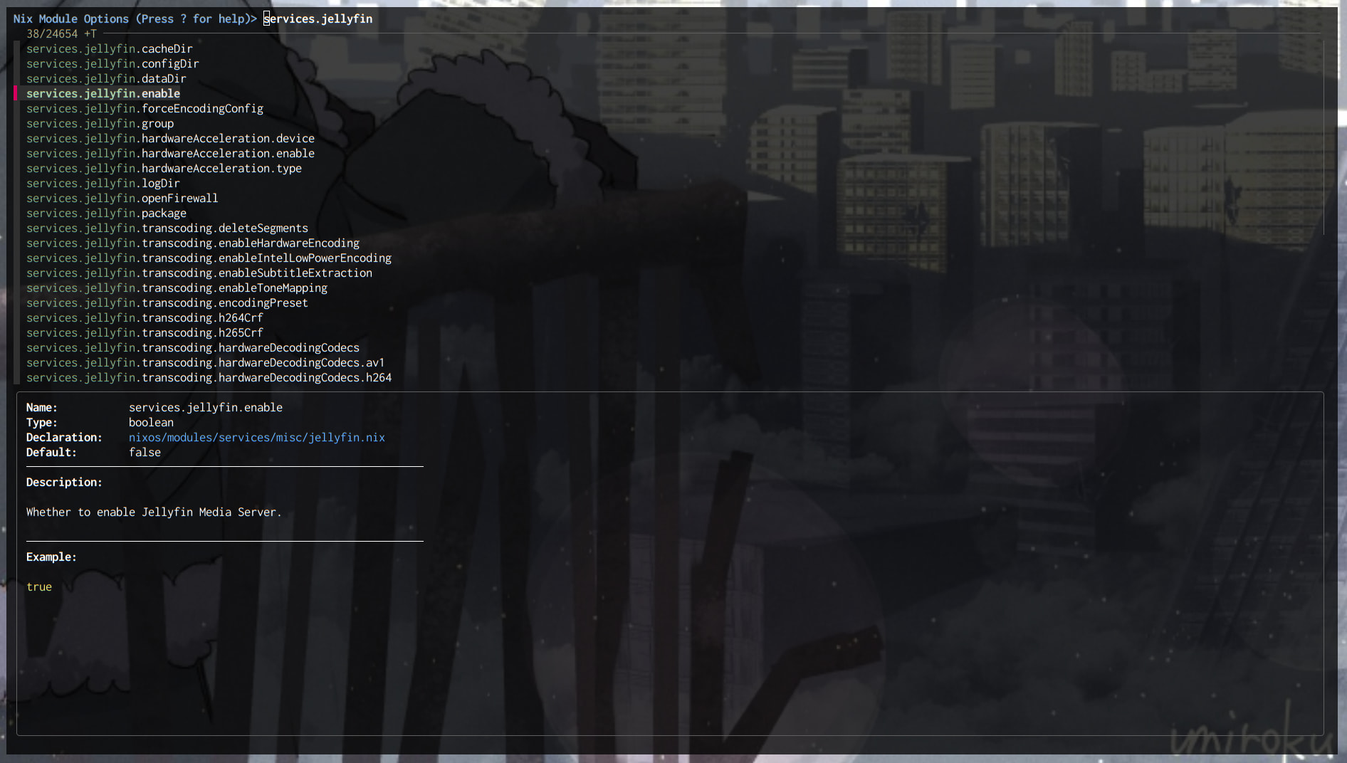

This one hasn’t moved in awhile but seems to wrap search.nixos.org (I was wrong, looks like they work from nixpkgs directly. They generate their own json record of all options and search with fzf) and works if you like TUI style:
$ nix run github:ciderale/nix-option-search
