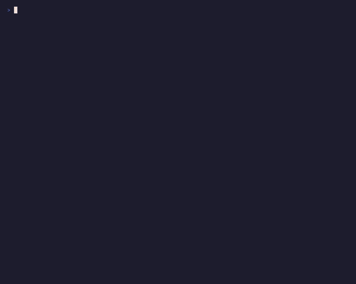

demo
$ nix-why-option .#myhost services.openssh.enable
services.openssh.enable : bool
  value     true
  declared  nixos/.../sshd.nix:241
  ✓ modules/system/global/base   priority 1000 (mkDefault)   → true
There’s also why-not (why an option isn’t set, including definitions sitting behind an mkIf that didn’t fire), what-sets, search, and small siblings for merge conflicts, overlay attribution, and reading an infinite-recursion trace. Works on NixOS, home-manager, nix-darwin and flake-parts, with JSON output if you want to script it.
Honest about the edges: the default view (value, priority, type, declaration) works on any config. The deeper per-definition view (--full) is best-effort and degrades on big imported configs. That’s a module-system limitation more than a nix-why one, and arguably the bit worth fixing upstream so any tool could use it.
It’s not a searcher or value browser like Optnix or nix-inspect, more the “explain the merge” counterpart to those.
