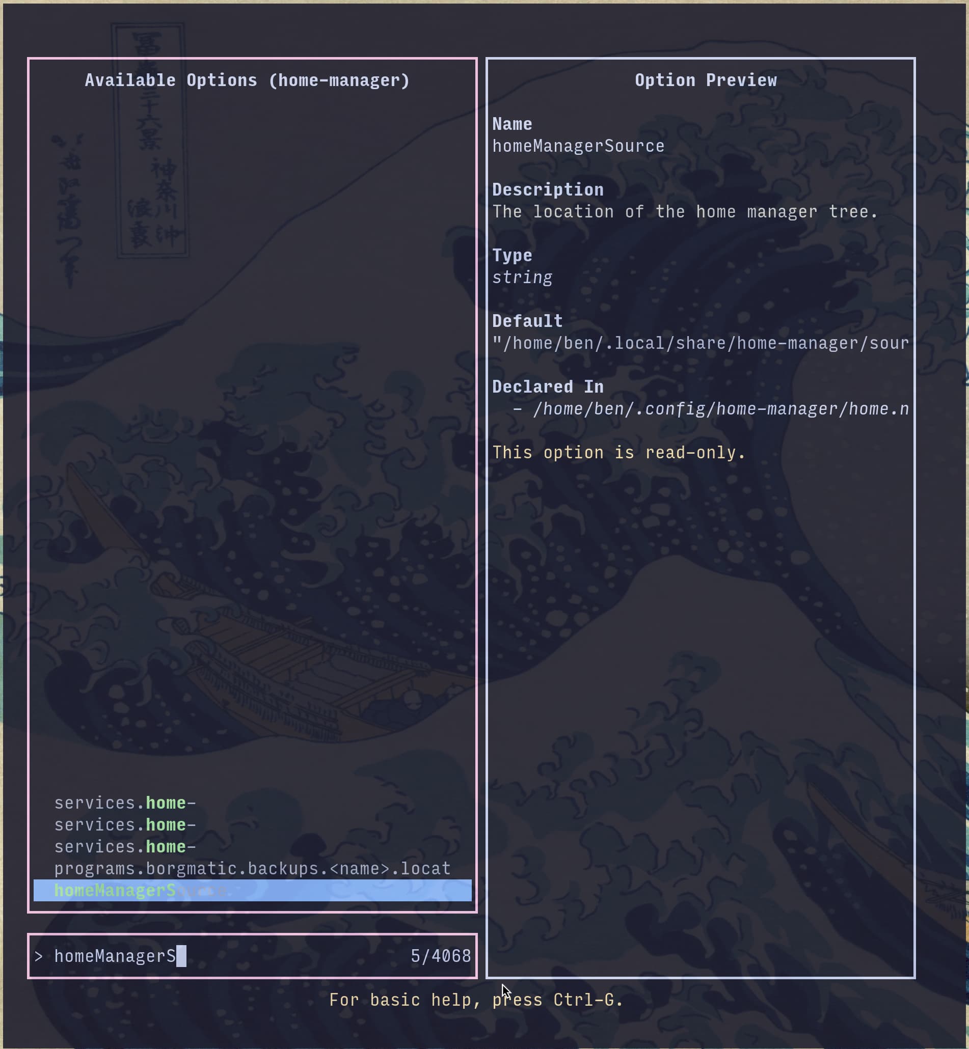

I finally got around to installing this. It’s pretty fun! Thanks for making it. I am having a few infelicities with generating my own home manager options set, but I don’t think that’s a flaw of the tool, mostly end user error :slight_smile: I’m currently using the following to generate my nixos settings at build time using npins / home-manager (I realised after the fact that you have a nicely packaged module in the flake, I’ll play with that later).

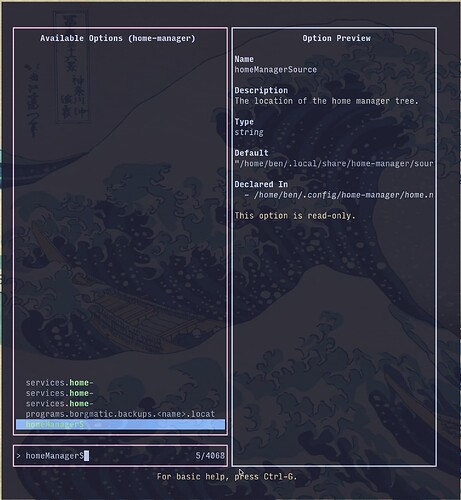

EDIT:
Very cool.

Probably 2m of work? FWIW running latest stable for nixos-25.05. This is slick. I like it.
