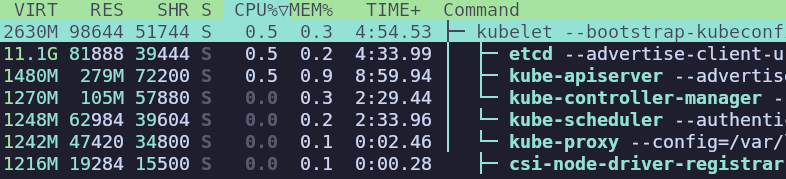

I mentioned in the post that I’ve written Kubeadm modules for NixOS. I think it’s time to projectify them into something others can use too! :slight_smile: K3s is usable on NixOS, though I always seem to have high idle-cpu that I can’t troubleshoot on K3s while Kubeadm runs so idle I don’t even shut it down while gaming! :slight_smile:
(+containerd 74MB res)
Along with modules for running Kubeadm I intend to write dinix modules called KNs that manages the lifecycle of Kubelet + CRI on any Linux distro that’s got Nix installed :slight_smile: It’s time for the Kubernetes community to embrace Kubeadm, upstream Kubernetes is where it’s at :bangbang:
(I’ve never liked the NixOS modules for Kubernetes, I think they’re replicating too much of what Kubeadm already does)

@claes Now I have a good example for how you’d develop your local application in a remote Kubernetes cluster swiftly and easily!
Starting from an end user perspective. I want to run pkgs.hello in a pod. How would I do that with your tooling?
