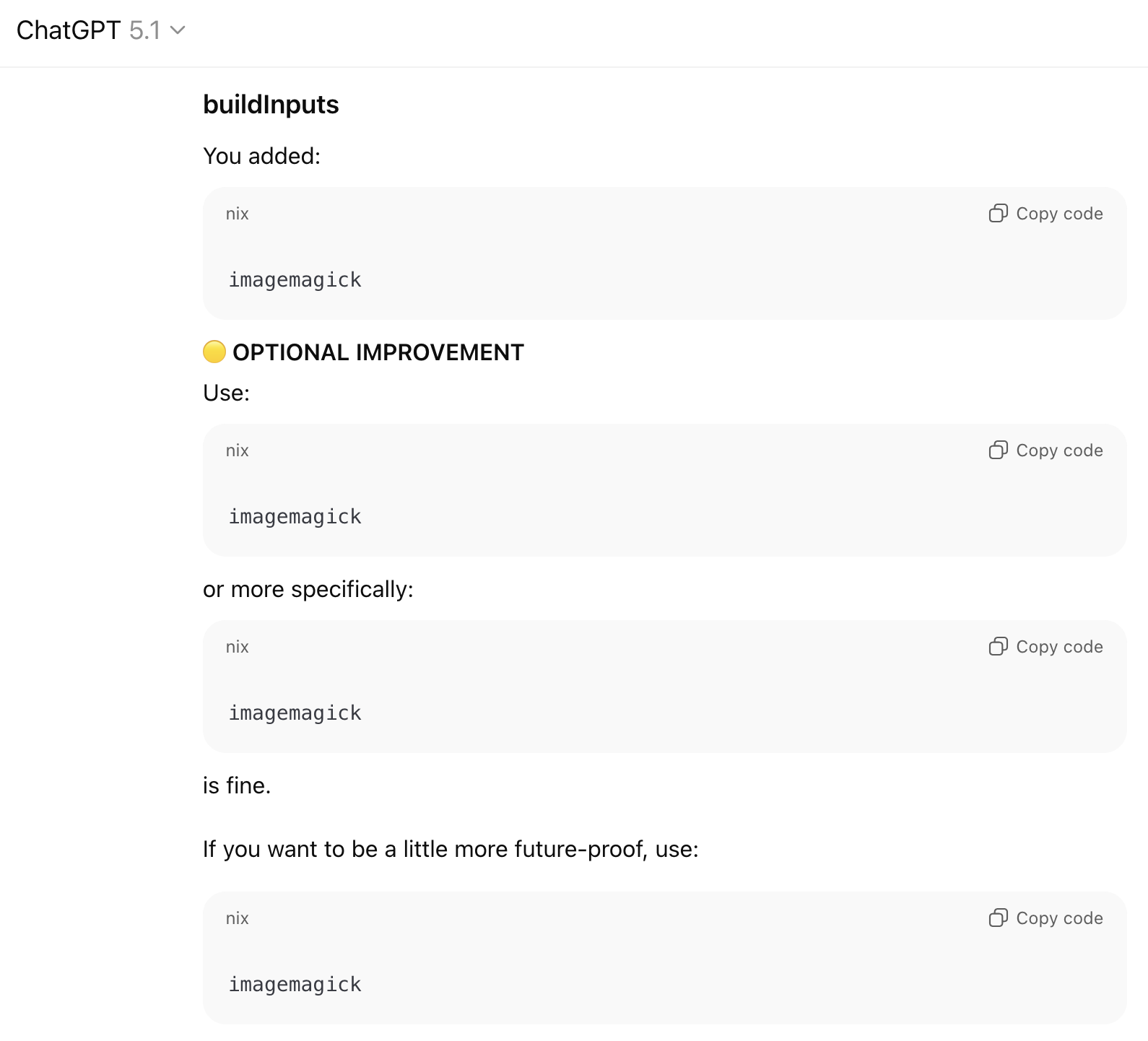

I’ve experimented lightly with things like this. LMs aren’t there yet for Nix/NixOS in my experience, but they’re getting there.
Seems the best way to make them sort of useful is to put a local copy of the manuals in RAG and give them access to a local checkout of nixpkgs for referncing. Generally, search tools just seem to make them hallucinate even more in my experience.

I have seen (in PRs I have merged) an inexperienced user ask CoPilot for a review, very reasonably dismiss half (because it’s pointless and/or misguided) but also force-push with the rest of the CoPilot suggestions applied (and I agree those were useful reminders). But probably an ability to correct the diff manually is still needed…
