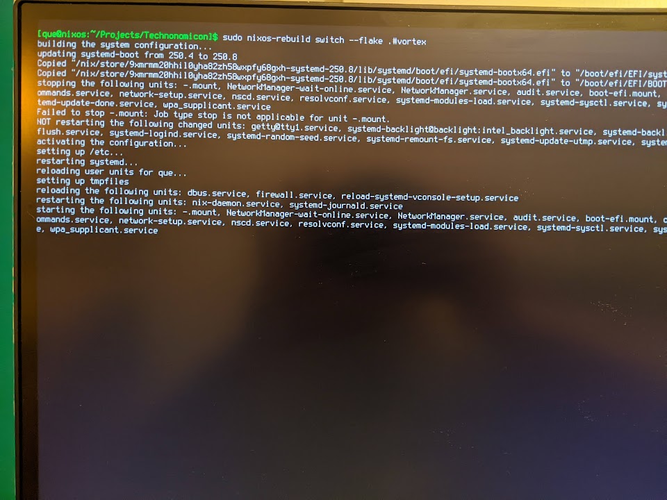

  6. sudo nixos-rebuild switch --flake .#vortex

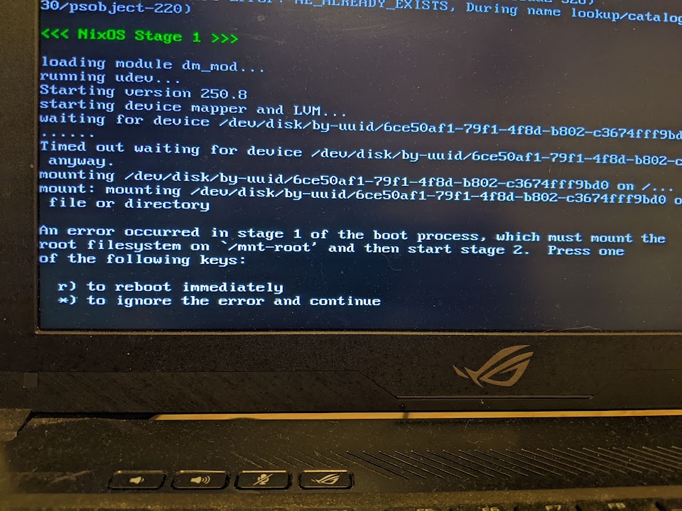

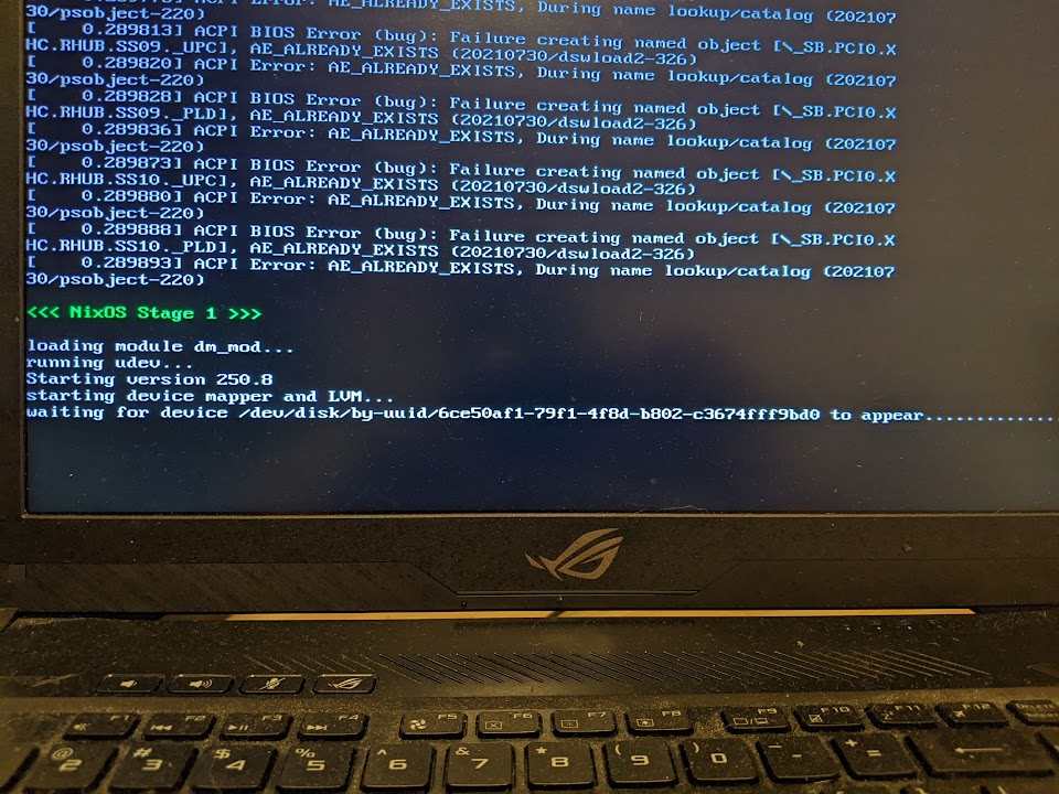

    This builds, but ends up stuck on this

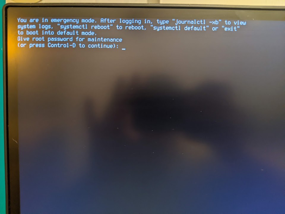

If I allow it to sit for a while. It eventually boots me to this screen.
C-d just brings me back to this same prompt. Rebooting from either the root shell option, or just normally turning the system on results in this prompt at start up.
which after a little while is followed by.

The posted screenshots definitely appear to support my suspicion, please check the UUID used to mount /. Or even better: mount by label/partlabel. Much less errorprone and can be controlled.
