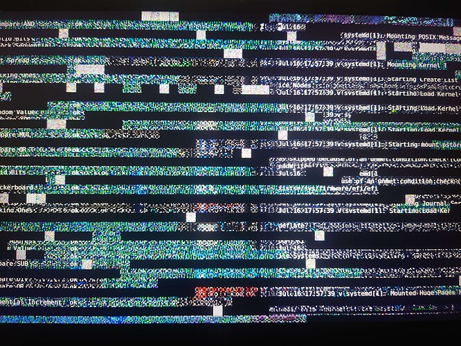

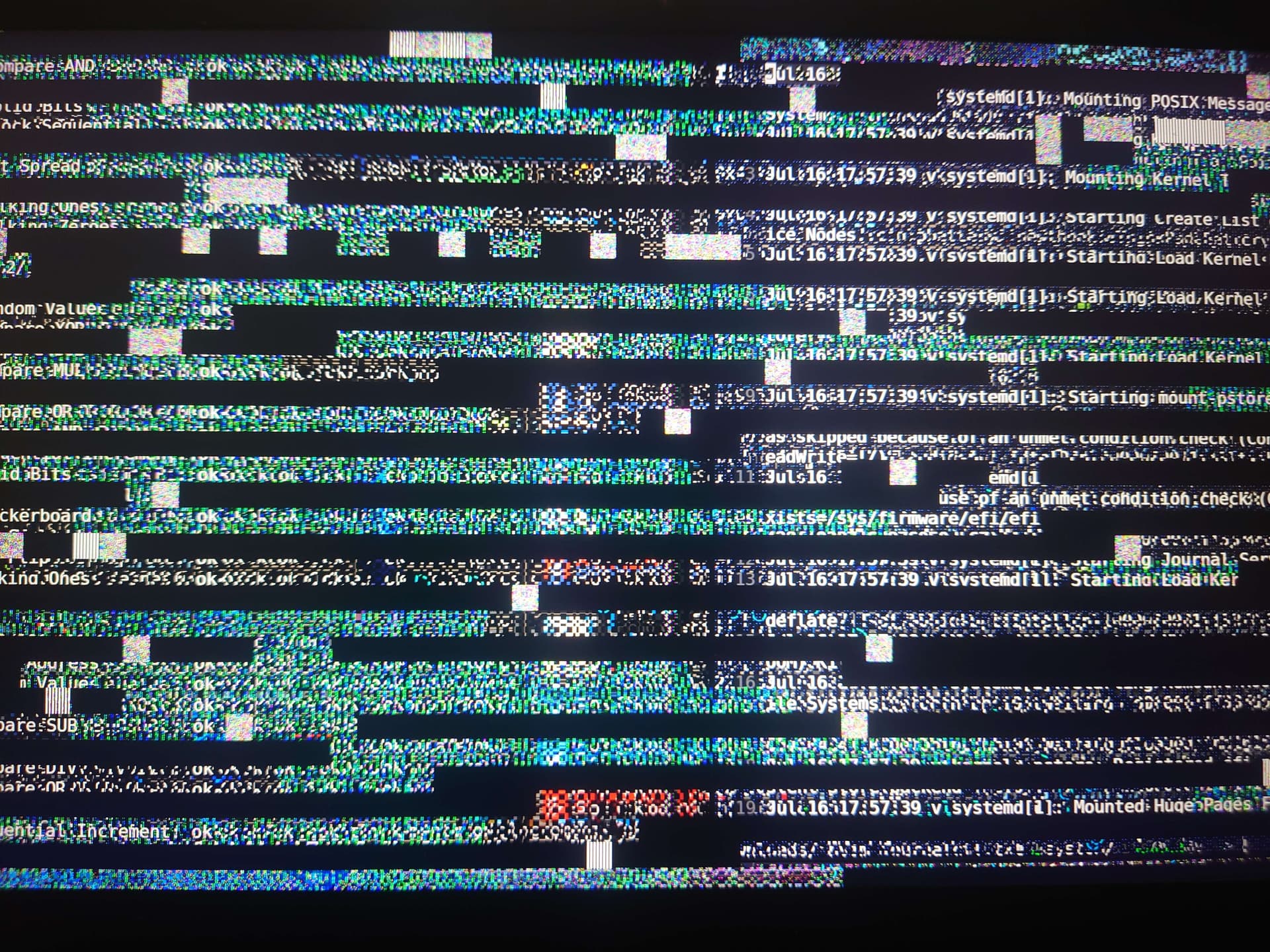

What does the crash look like: screen freezes with always the same visual artifacts.
OS seems to freeze too, since nothing happens when I try to use commands (shutdown or reboot).

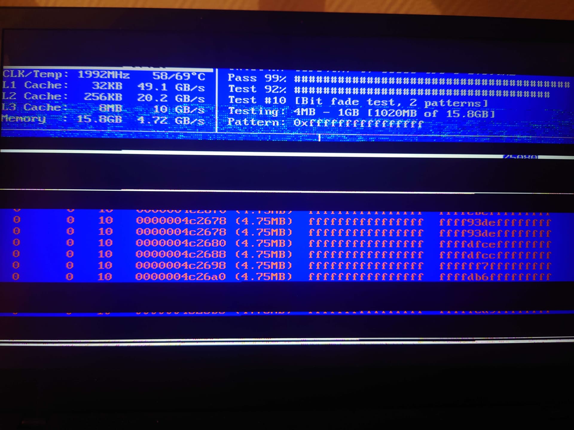

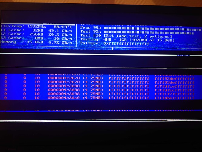

It did not go well lol (I don’t know how long it lasted, i was away for a few hours).
I used nix (boot.loader.systemd-boot.memtest86.enable = true;) to enter memtest86, but i assume that if I crashed there, it’s definitely hardware, right?

Yes, «crashes in a similar way both for Linux and for Memtest86» is more OS-independence testing than other Linux distros can provide…
Stupid question: have you looked at the temperature and whether the fans should be working and whether they can be heard? I am not sure that just bad RAM can crash Memtest86 like that, and I have seen overheating with a lot of visual similarity…
