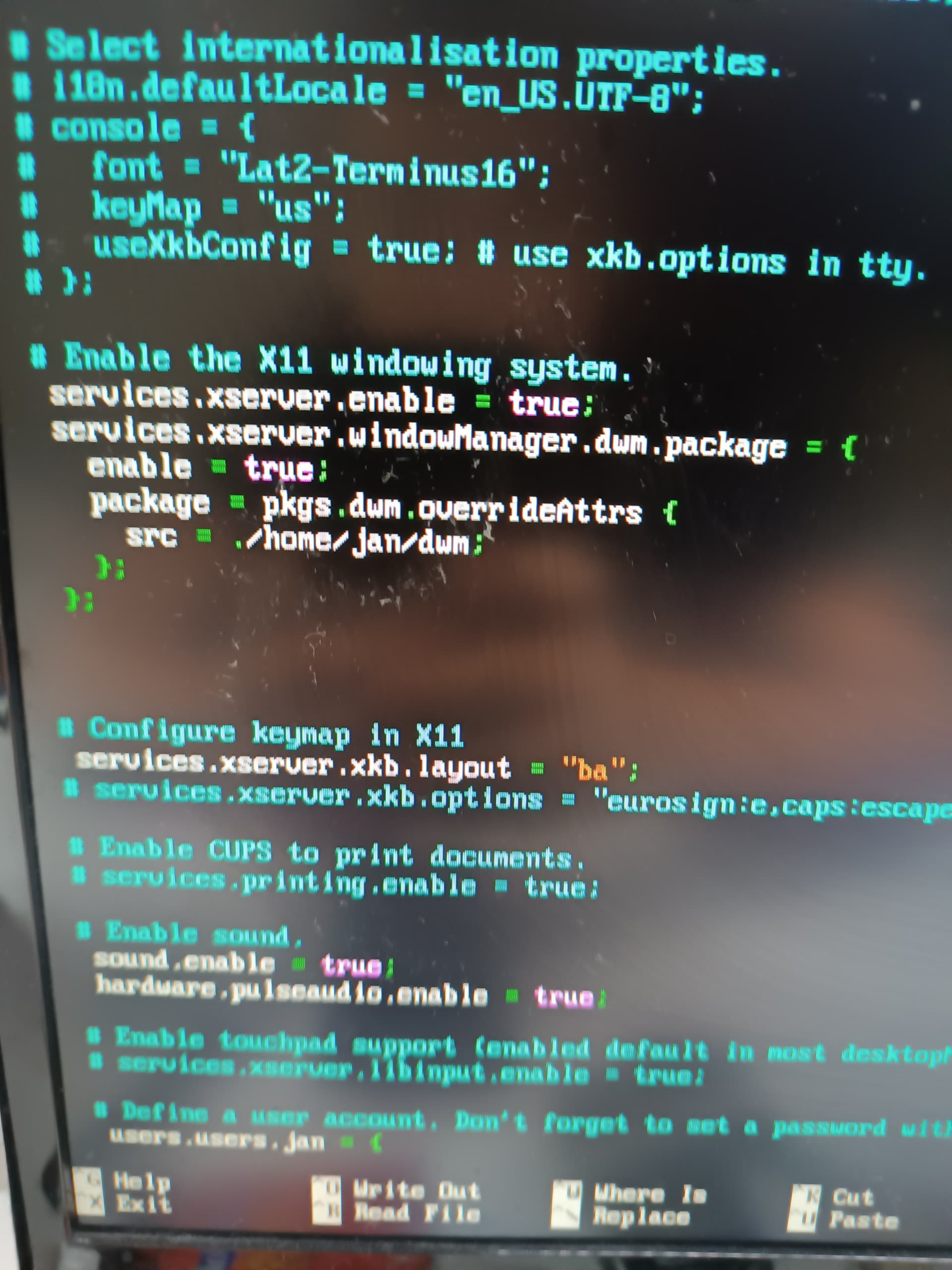

Thanks for the reply! I have added that into configuration.nix and ran the command "sudo nixos-rebuild switch’ and it errors out. I cloned dwm repo to my home folder and in conf.nix I placed src = ./home/jan/dwm. What did I do wrong? I can send a picture if needed.
It rebuilt successfully now, but on login in it says failed to start session.

Edit: I’ve just realized this, but the way dwm was defined is wrong:
- services.xserver.windowManager.dwm.package = {
+ services.xserver.windowManager.dwm = {
There is no dwm.package.enable or dwm.package.package.
