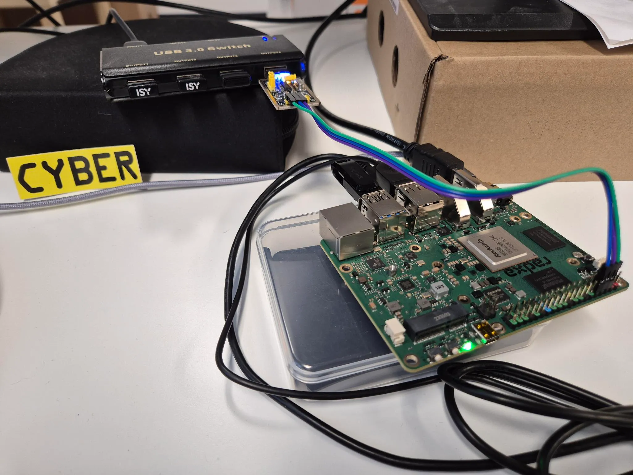

I managed to get U-Boot and Linux to start on my rock5b, however during Linux boot the UART logs suddenly stops sometime during a line print and the board is stuck without rebooting.
At first I thought this was due to my PD power-supply as I know that the Rock5B fusb302 is not working great with some power-supply but after instrumenting the code I can see that U-Boot fusb302 driver selects 20V@3.25A which is plenty for the Rock5B. Any idea?
I’m using boot.kernelPackages = pkgs.linuxPackages_latest; and uboot = pkgs.ubootRock5ModelB; here is my flake and config that builds me an sdcard image to flash
Any idea?
Here is my Linux logs, I find it strange that it always stops after some lines regarding usb connector as the power commes from the usb-c port. Also I get the Booting Linux line twice on CPU 0x0 which seems odd:

Hi!
Maybe you’ve tried this, or maybe you need to have an sd-image, but on my Rock5B I just wrote the installer to a USB thumb stick and installed it (in my case to an nvme drive) like I would on x86. Have you tried the installer?
I got curious about sd-images so made an example that works for me:
  inputs.nixpkgs.url = "github:nixos/nixpkgs/nixos-26.05";
  outputs =
    { self, nixpkgs, ... }:
      nixosConfigurations.sd-image = nixpkgs.lib.nixosSystem {
        modules = [
            { lib, modulesPath, ... }:
              imports = [
                "${modulesPath}/installer/sd-card/sd-image-aarch64.nix"
              boot.kernelParams = lib.mkForce [
                "console=ttyS2,1500000n8"
                "root=fstab"
              networking.hostName = "sd-image";
              nixpkgs.hostPlatform = "aarch64-linux";
              users.users.test = {
                isNormalUser = true;
                password = "1234";
      packages.aarch64-linux.sd-image = self.nixosConfigurations.sd-image.config.system.build.sdImage;
I built and wrote the image to an sd card like so:
$ nix build .#sd-image
$ zstdcat result/sd-image/nixos-image-*.img.zst \
  | run0 dd of=<sdcard-device> bs=4M oflag=direct,sync status=progress
I guess that if the above image config (or the minimal aarch64 installer) doesn’t work for you it’s either:
  • a problem with Radxa’s u-boot (which you can replace with the mainline one in a similar way to the linked post above using rkdeveloptool)
  • like you first considered the power supply isn’t up to it, although in my experience the board would completely reset and even then only under load (like building my rust toolchain).
I will try your example. Mine is not that far off your but who knows.
I didn’t try with an USB stick but I should work as U-boot for Rock5B has support for usb
For Any rk3588 boards, try this framework, GitHub - qbisi/nixos-images · GitHub
