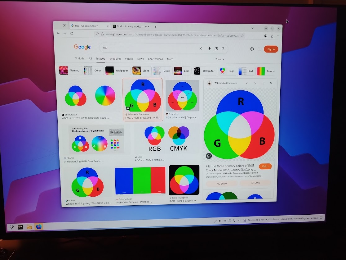

Hello, I’m trying to set up a raspberry pi 4 as a kiosk running Kodi. However, the display is very laggy, doesn’t take up the full horizontal resolution, and has the red and blue channel swapped:
I flashed the same SD card to the stock raspberry pi OS (Debian Bookworm, kernel 6.12) and had none of these problems, so it’s not hardware related.
I also tried using a variety of display manager setups: cage (what i want for my application), Plasma 6, and gnome on both x11 and wayland, and all had the same issues (although gnome x11 was less laggy). If anybody has any suggestions on how to get the graphics looking normal (and ideally at the correct resolution) that would be great!

Hi, I had this same issue with the colors a while back. It was resolved by using the (now archived) raspberry-pi-nix repo. This repo contains an image that should work with correct colors on the pi4. I recommend looking into what’s done in the raspberry-pi-nix repo, I haven’t bothered doing that yet.
