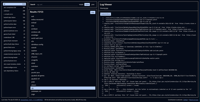

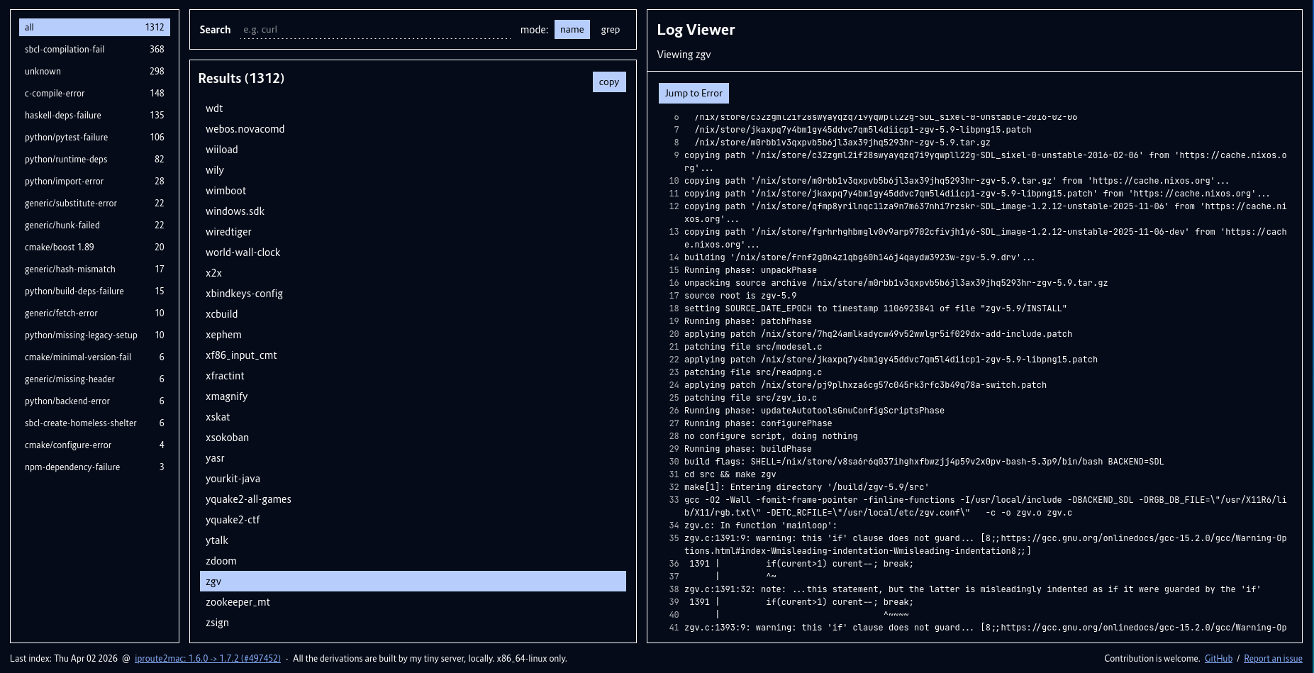

Finding and searching through logs on Hydra can be a bit of a friction point, so I built this to provide a simpler interface to the logs.
You may know that I’ve written a small tool to collect hydra failures into CSVs, nixpkgs-failure-notify. While this has been useful, I wanted to grab the actual build logs behind each failure, but I did not feel too good about scrapping hydra to download them periodically.

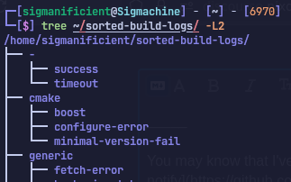

Instead I started building that list on my own server, as an little experiment. Turns out that having a folder with 1500 build-logs alone was not the great, so i made a very rudimentary attempt at sorting them:
Fast forward a few month, I wanted to make a little project to clear my mind of all the stressful exam i just passed. I thought of that list i gather that was rotting on my computer, what if i pushed that little sort-stuff.py a bit more and made it public for anyone to take a look?
And here we are:
Now it does build a good chunk of nixpkgs (master), almost all packages tags that are exposed by recursionMode = "hydra", and builds on x86_64-linux. Note that i use substituters and a timeout of ~30s per derivation to make it manageable to build within a bit more than a day. I’m not exactly sure on which frequency i will put the job on as i got some more experimentation to do with it, probably 2 days to once a week.
It hit 105952 attribute paths in the last iteration, out of which 22131 where not building on my system, and 3852 were timeouts. After the classification and the filtering out of irrelevant errors (e.g. incompatible system, file required, …), I got down to a ~1300 failures list that seems exploitable.
There is a lot of I low-hanging fruits!
I also refined the grouping of failures, and it works better than i expected! You might also noticed that some of them are tracking issues (cmake minimum version or boost 1.89). If you have an idea for a new group, feel free to test with the grep mode, and open an pr to add it.
This is not a big project per say, but it’s nice to revise a bit my front end skill and trying to use the branding guidelines :‌o

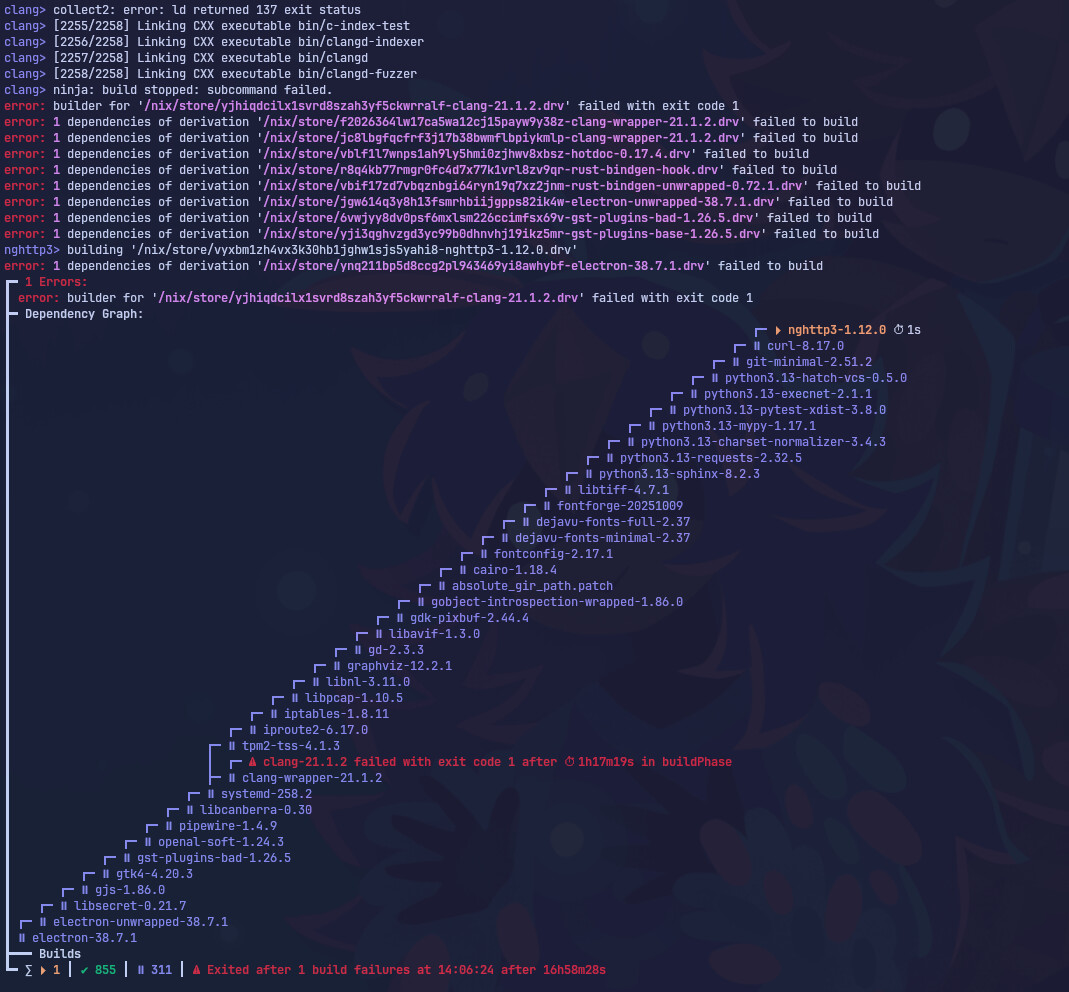

So, wait, this thing is building All The Things locally in order to get the build log failures?! How much compute power are you handing it in order to push through in one day?
@greg-hellings My vps 8-Core Xeon E5-2680 :sweat_smile:
It really is not that bad, because it actually only build the path that are not substituted by the nixos cache, and on a future version it will not even have to download them. A good chunk of time is spent on nix-collect-garbage currently, since i pull ~2Tb…
I dispatch one build per core, and i have a very low timeout, since the goal of the tool (for me) was primarily to identify low-hanging fruit! I will probably bump it a bit when i’ll have the afford-mentioned optimization.
Sadly building everything from scratch is not even remotely feasible. My server does not surive the clang build. Here you can see it crash after almost 17h of compilation :‌D
(I dont remember why i was building electron on staging tbh…)
Ah, that makes more sense. I usually have my laptop plus three large-ish desktops as remote builders and it still takes a reasonably long time to build even a modest subset of things when I’m compiling a non-cached target like crossPkgs. I’m definitely going to check this out!
