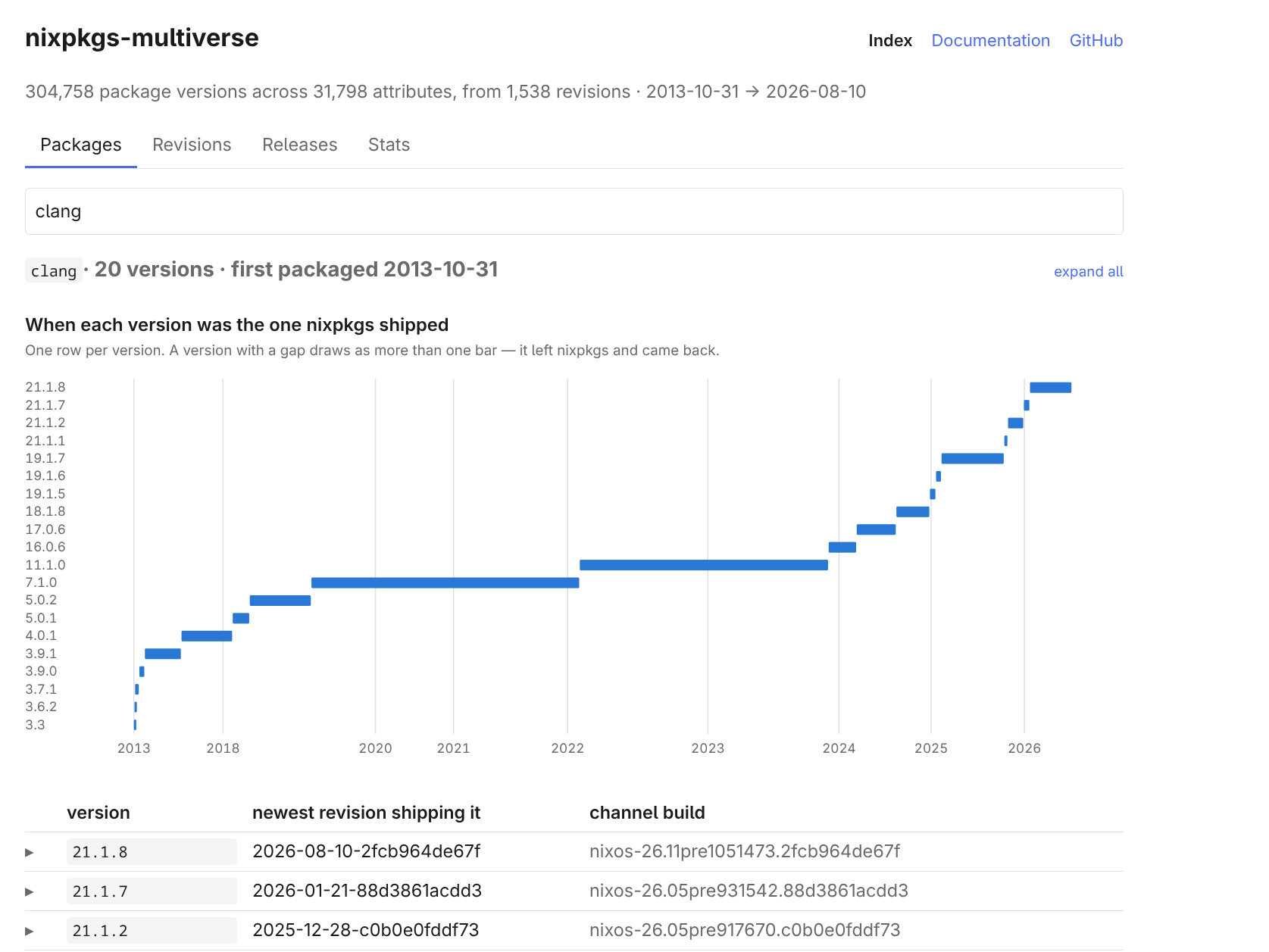

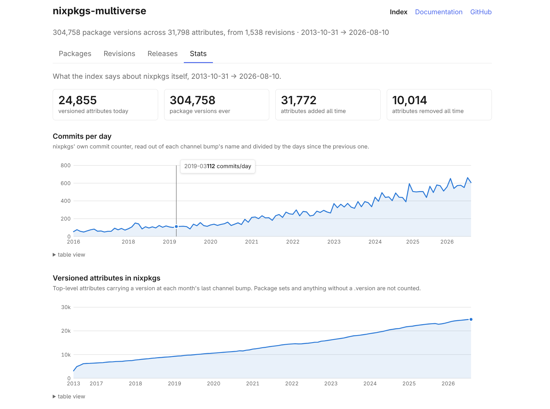

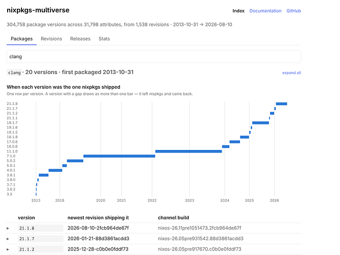

Nixpkgs-multiverse: every version that ever existed
Disclosure: AI helped for in tool and graph creation.
