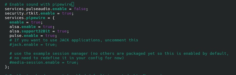

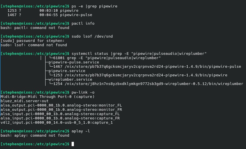

As can be seen above, I appear to have pipewire services running, but the commands that I need to follow the relevant threads (such as ‘aplay’) are not available to me. I have searched for an ‘aplay’ file on the system, (a possible pathing issue) but haven’t found one.

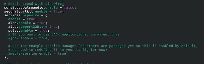

The pipewire declaration in my configuration.nix created by the installer appears to be exactly as it should be. Although new to Linux, I have programmed on UNIX (mainly AIX) for many years, but only have limited sysadmin experience. This ought by rights to be something really simple, but I can’t for the life of me see what it is! Any help will be much appreciated.
Aplay is part of alsa. You’ll find it in the alsa-utils package.
Regardless, whatever guides you’re following are not pipewire-specific, they seem to be instructing you around alsa/pulseaudio.
You should definitely not both be using pulse and pipewire the way you currently are.
