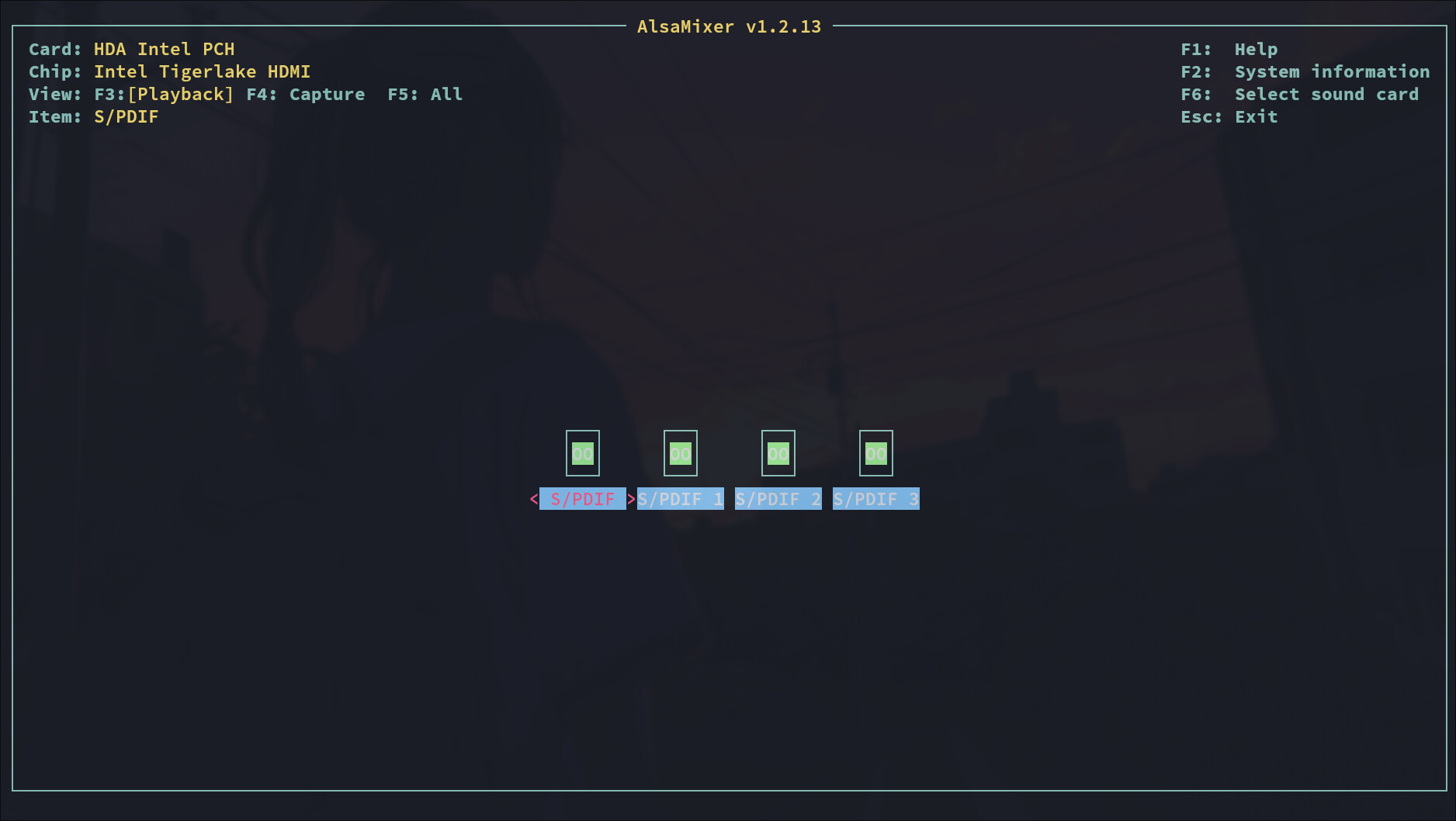

  1. Install alsamixer. Ensure that the correct sound card is selected and that no channels (like Master, PCM, Speaker) are muted (look for “MM” versus “OO”) or set to low volumes.
  2. Verify Audio Devices:
    Run aplay -l to see if the sound card is correctly listed. You can also check your audio server’s sinks (for PulseAudio or PipeWire) using: pactl list sinks

Ok so the channels are not muted.
