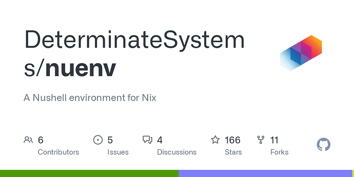

Nuenv: an experimental Nushell environment for Nix
As a fun and ultimately quite fruitful experiment, I created an environment for Nix based on the amazingly powerful and expressive Nushell as an alternative to Nix’s Bash-based standard environment. You can read about it on the Determinate Systems blog and check out the repo on GitHub:
While Nuenv isn’t yet particularly powerful, it does open up some pretty intriguing horizons, as Nushell offers an expansive feature set that includes:
  • Built-in support for JSON, YAML, TOML, SQLite, and others
  • Custom commands with typed inputs that feel more like CLI tools than Bash functions
  • Dramatically improved handling of things like strings and environment variables
  • A broad palette of utilities that replace and go beyond the standard GNU coreutils
  • Scoping mechanisms like modules and overlays
Plus, Nushell is a fairly new and very actively updated project, meaning that Nuenv can take advantage of any forward progress on the Nushell side.
While I encourage you to check out the blog post and the repo, you can give it a try immediately if you have Nix installed and flakes enabled:
