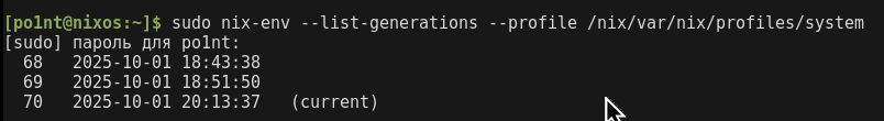

nope, still doesn’t load. sudo nix-env --list-generations --profile /nix/var/nix/profiles/system gives:
boggles - the modules are still not in /run/booted-system?
no, they aren’t. did exactly like you told :sob:
Yep, this is pretty crazy. Your configuration is producing the output I’d expect and certainly correct, but when booted into it it seems to have different contents than it does at build time. This seems pretty much impossible.
