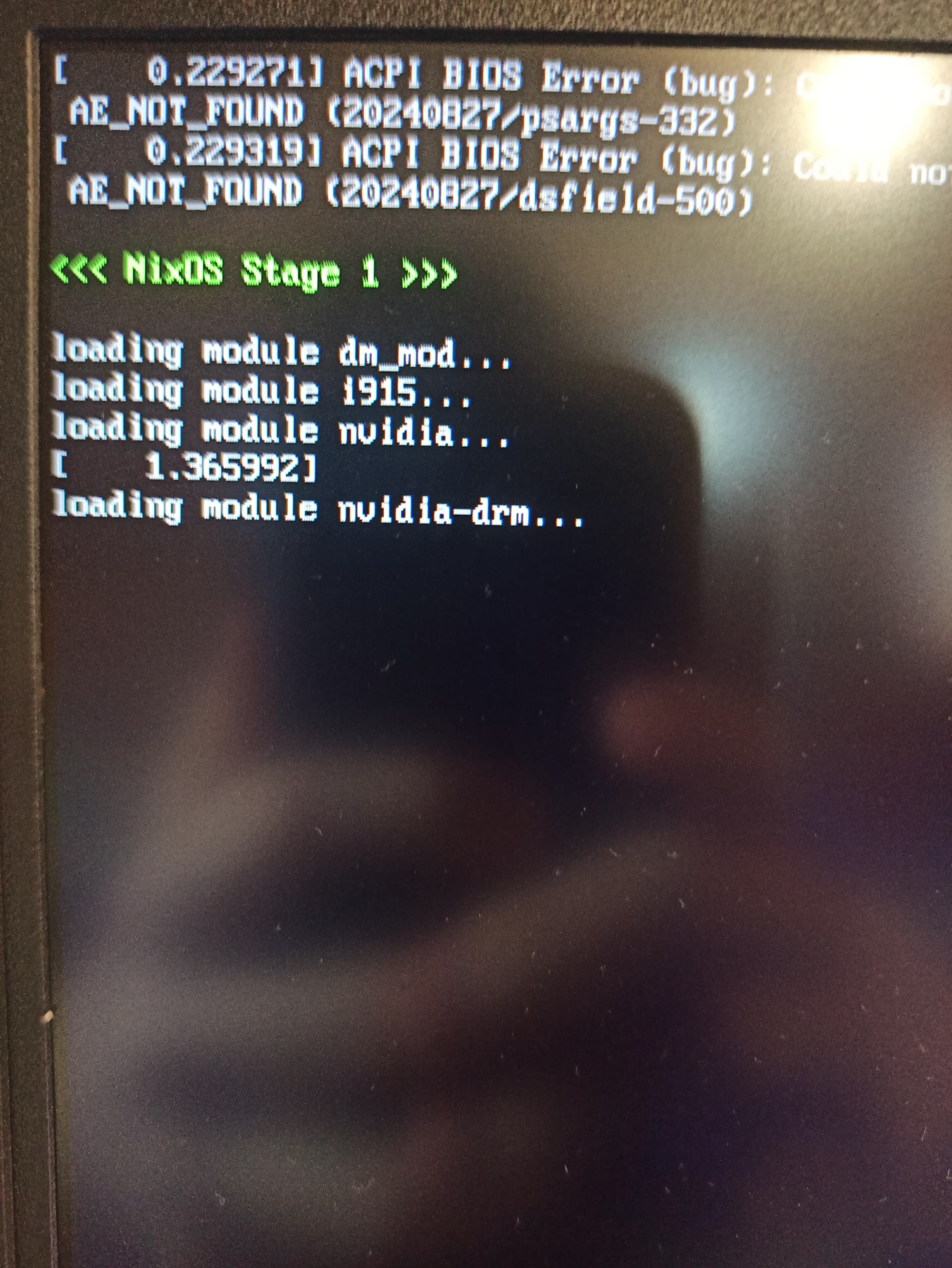

Nvidia-drm fails to load
after this thing on the image it just fails with time-limit. that happens every time i try to enable my config with nvidia proprietary drivers support.

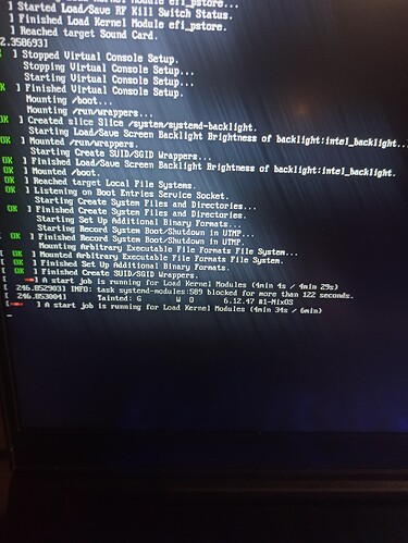

(there’s also smth like ā€œfailed to load kernel modulesā€ message after this stuff on the photo)
then system tries to enter display manager, which obviously fails too. in case of sddm, it’s just black screen with underscore, in case of ly - smth like ā€œsystemd-modules: failed to loadā€ and then nothing.

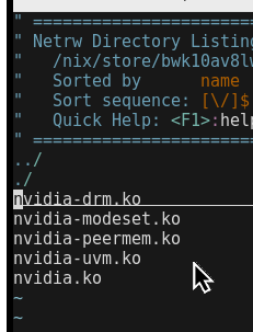

now that you mentioned it - checked /run/booted-system/kernel-modules/lib/modules/6.12.47/kernel/drivers/video and there’s no symlink to nvidia.ko.xz. then i ran nix eval --raw .#nixosConfigurations.nixos.config.hardware.nvidia.package.bin, checked this directory (/nix/store/bwk10av8lwhfrpcm2sjm7c2lczhk0nkz-nvidia-x11-580.82.09-6.12.49-bin) and nothing seems to be off (maybe because i don’t really know how it should look like), there are some binaries in /bin, and spooky-scary files shown on screenshot in /lib/modules/6.12.49/misc
those files seem to be those exact modules that should be symlinked in /run/booted-system stuff, but i’m not really sure and honestly i’m completely lost and don’t know what to do, the arch-user part of me is really scared to do anything that could break the system :sweat_smile:

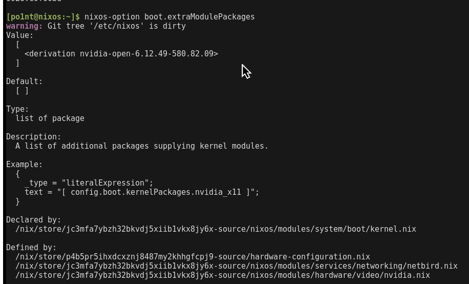

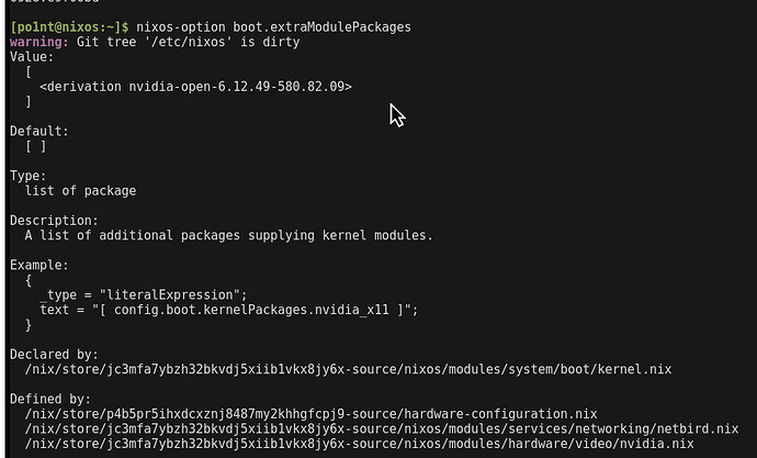

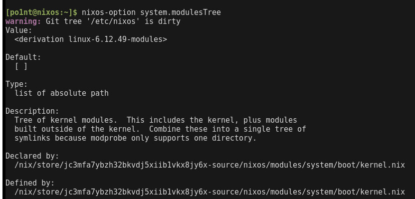

I don’t see anything in your configuration that would cause this to fail. It’d be interesting to see what nixos-option thinks the value of each of those options is after evaluation (i.e., system.modulesTree and boot.extraModulePackages).
My best guess at this point is that you’re not sharing your whole configuration somehow and that somewhere you’re doing something that overrides system.modulesTree somehow, but I haven’t a clue how you would even accomplish that.
checked it, the one thing that concerns me is that the only path it has is /lib/modules/6.12.49/kernel/drivers/video and the same files as i mentioned before, but with .ko.xz. honestly i don’t really know if it should be like that, so i leave it on you :sweat_smile:
