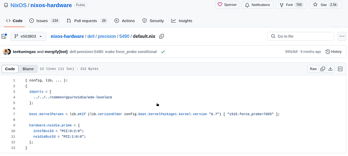

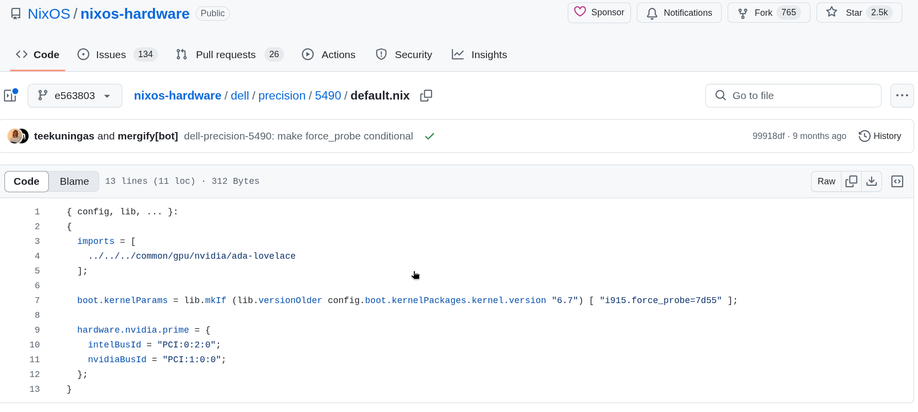

If that still didn’t work, you can take a look at the modules in nixos-hardware/dell/precision, which might be useful.

I’ve given a look (and tried) the precision’s page. 3590 (mine) is not listed; besides that, all nvidia drivers/configs are for different videocards. This is not even seen just as “VGA” adapter only, but with “VGA” and “3D” controller. It seems that Ada 500 generation is not yet supported by nixos atm.

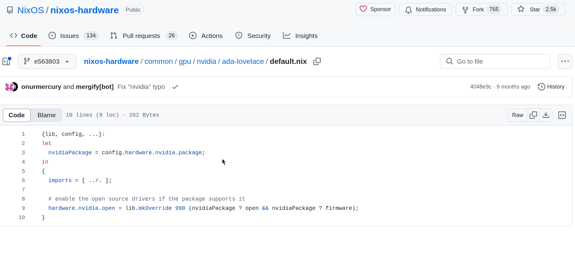

It contains configuration specific to the ada-lovelace architecture of 500A (../../../common/gpu/nvidia/ada-lovelace)
may i also clarify if you implemented the solution proposed by @eljamm :slight_smile: :
Try early-loading the drivers:
boot.initrd.kernelModules = [ "nvidia" "nvidia_modeset" "nvidia_drm" "nvidia_uvm" ];
# or with iGPU
#boot.initrd.kernelModules = [ "i915" "nvidia" "nvidia_modeset" "nvidia_drm" "nvidia_uvm" ];
or blacklisting the iGPU:
boot.kernelParams = [ "module_blacklist=i915" ];
