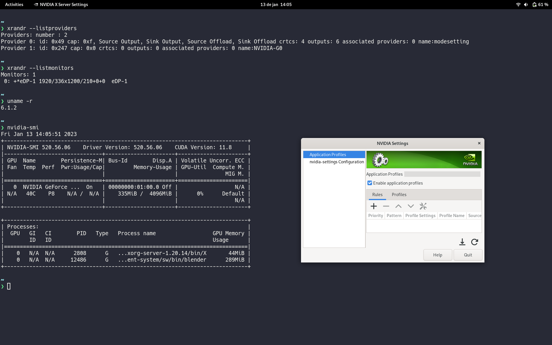

My question is, the Nvidia-Settings does not show any GPU info at all? I would like to see if the sensors and FAN are working normally (like PopOS show).
I made the same configuration as the Nvidia wiki. nvidia-smi shows some information and nvidia-offload works too, for example if I run nvidia-offload blender I will be able to see the process in nvidia-smi and blender will open normally.

  • uname -a
Linux Niflheim 6.1.2 #1-NixOS SMP PREEMPT_DYNAMIC Sat Dec 31 12:33:12 UTC 2022 x86_64 GNU/Linux
  • lspci -k | grep -E “(VGA|3D)”
00:02.0 VGA compatible controller: Intel Corporation Alder Lake-P Integrated Graphics Controller (rev 0c)
01:00.0 3D controller: NVIDIA Corporation GA107M [GeForce RTX 3050 Mobile] (rev a1)

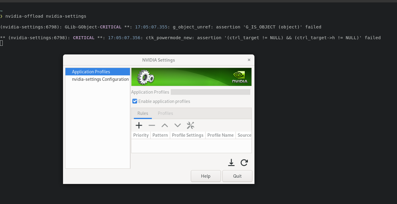

This is just a shot in the dark: what happens if you run nvidia-offload nvidia-settings?
No problem, I tried this and the app runs with these errors on terminal
I wonder if enabling the systemd-controlled powerManagement features disable the usual power management related tabs in nvidia-settings.
Those gobject errors are harmless, I believe they are thrown when certain GNOME services are missing, which is most likely because you’re not using GNOME but some wm. If you are using GNOME and the screenshot cropping is just hiding all of it, obviously it’s not the lack of GNOME, but I’ve personally yet to see an application using gtk not throw a few errors like those.

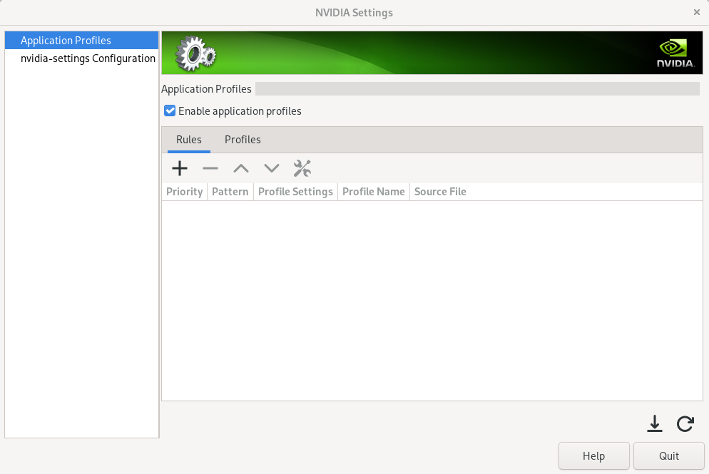

Sorry for the delay, but yes, X is running. I believe it is more UI configuration of nvidia-settings than something wrong, because in nvidia-smi the GPU config appears and I can run programs with nvidia-offload. I’ll install the stable version and see.

And yet nvidia-settings still doesn’t show the nvidia configuration, but I’m managing to run the programs using nvidia-offload and they appear running in nvidia-smi, I believe I’m having a problem in the nvidia-settings UI and not in nvidia itself. I’ll try a few more things.
