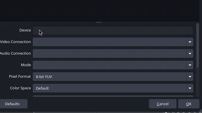

Hi. OBS won’t detect my DeckLink Qaud HDMI Recorder. I have set hardware.decklink.enable = true; and have a package override on obs-studio with decklinkSupport = true;. While OBS shows the “Black Magic Device” input option, no device shows up in the selector. I am using nixpkgs on nixos-25.05. Kernel modules are loaded correctly.
Could this be because of the firmware version mismatch? The drivers should be backwards-compatible as far as I understand BlackMagic’s release notes.

OBS Blackmagic Device selector:
