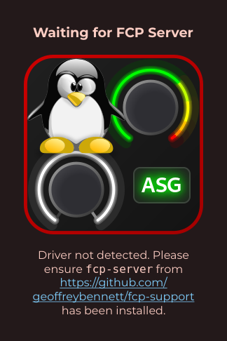

Hello! Back again, needing help to package yet another piece of software. As it turns out, my new audio interface needs this driver in order to get the full functionality and use the control GUI.
I went ahead a whipped up a quick Nix derivation by copying the package source for the control GUI, added a couple dependencies, and got it to install without errors, at least. However, I still get the same error message as before, indicating that the driver isn’t working as intended:

Any ideas what I’m missing? I think possibly a udev rule?
I’m also pretty sure I have some unnecessary dependencies in there, as well.
Just to check before going further down that rabbit hole, lsmod lists fcp?
As for your package, by setting an installPhase you’re overriding the built-in installPhase that installs using make, so you’re probably not installing any of the actual binaries. Remove your installPhase. You can use nix-build or nix build to build that package, and look at the result directory it creates to see if you got it right. Share the file list so we can see it too.
There are udev rules, data files and even a systemd service which will need special handling. But before we can tackle all those, figure out what make install puts in your package’s result - then we can worry about creating a module that actually “installs” these things on NixOS.
Not seeing anything related to fcp when I do an lsmod unfortunately, but good call.
Oh goodness, that installPhase bit was an mis-paste, I’m not even sure how that got in there and I’ve removed it from the post.
When I nix-build without the installPhase junk, my results folder is structured like this:
Kinda looks like it’s installing as expected at least? Definitely need to get the udev rules, data files, and systemd service figured out next, like you said.

Well I was able to test it, and it seems to work exactly as expected. The only kind of quirks are that it seems to absolutely detest connecting at boot, so the hardware has to be either power cycled or just disconnected and reconnected at boot. This kind of sucks because the power switch on the unit is awful quality. After power cycling, it works just fine.
The other thing is that I can’t seem to figure out is the correct kernel module to set as boot, as I’m still not seeing anything FCP or Focusrite specific when I do an lsmod. In either case, it seems to work without it, other than the aforementioned need to power cycle the unit.
I would be happy to be a maintainer if you want to upstream this. Not sure if it’ll benefit many people, though, since this driver is only needed for the 400+ USD units, but I’m definitely on board.

I suppose I should update here to say the dev responded to my question and basically just said what I’m experiencing is normal. He said power cycling the unit is the easiest solution, which I’ve found to be true. He also mentioned this CLI command could be used to trigger the driver manually, but I haven’t gotten it to work and don’t necessarily care about that:
sudo udevadm trigger --action=add /sys/class/sound/controlC0
