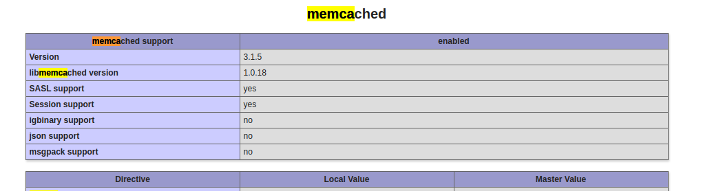

So that worked now, I put the part in configuration.nix now and memcached and imagick is running. Now I have to deal with the nix-shell. I haven’t really dealt with that yet.
What still doesn’t work is the command “php -m | grep memcached”. It does not produce any output. However, php.info says something different.
Thanks a lot for your help, once again. I am also sure that you can help me a few more times. ;0)
Thank you!
