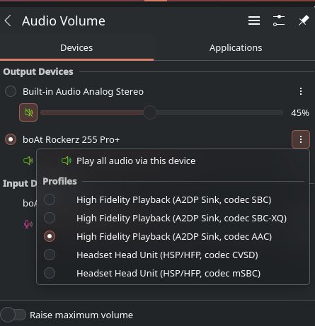

Maybe I didn’t mention it clearly. It was very very bad when I used the CVSD. I wanna do basic meetings with my earphones in decent quality atleast. The earphones record super clearly in mobile though.
Image: Only when I switch to that CVSD mic works, but listening and recording quality is crappy.
When given any other codec there, mic stops working, but can listen in good quality.
