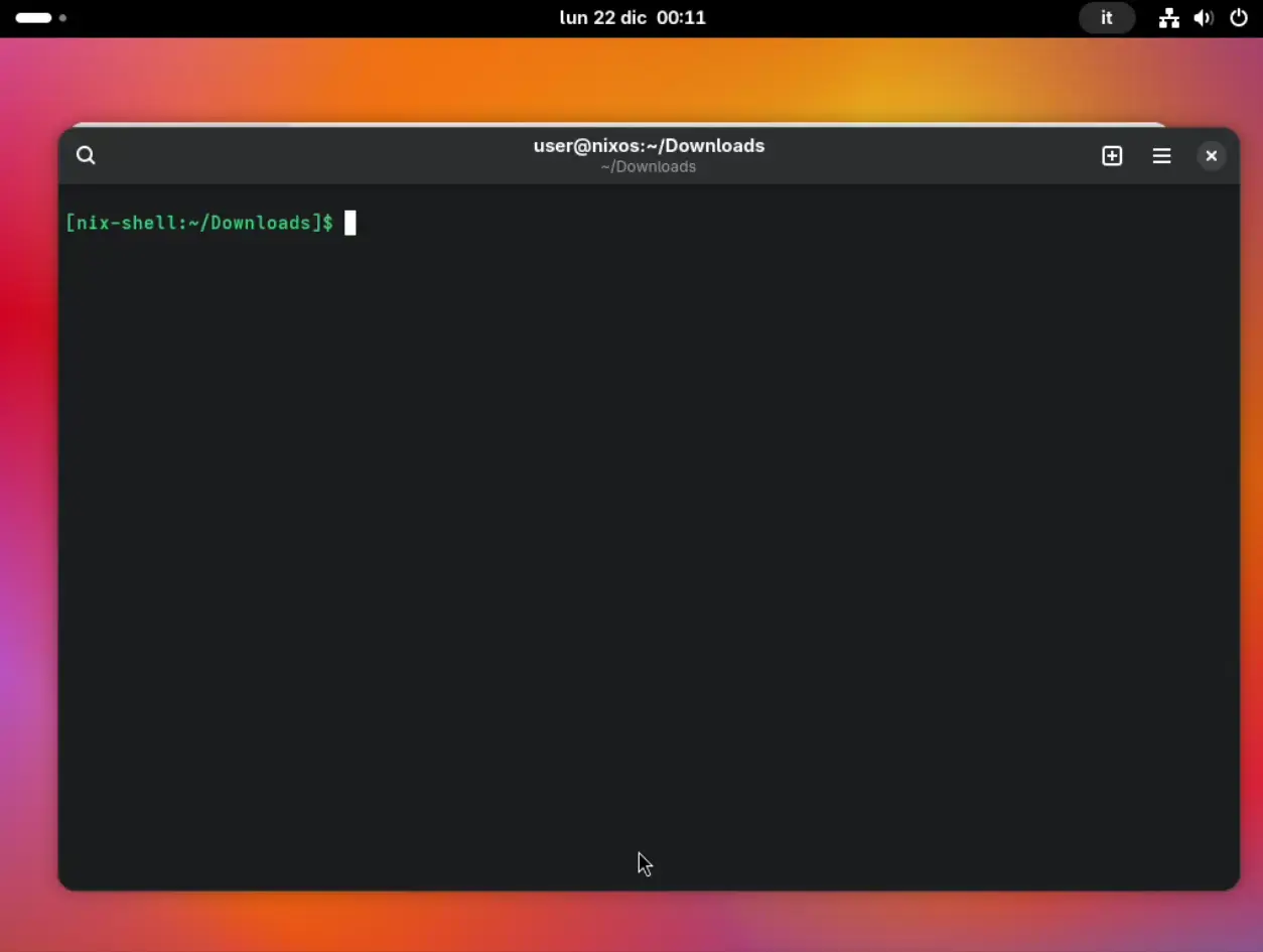

This is a recording from the VM which illustrates the issue (open in a new tab if the animation does not work):
stuck
(sorry for the huge file, I could not upload video so I made a webp animated file. If necessary I can upload the video somewhere else)
