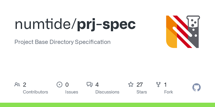

After some rounds of feedback, a direnv lib for the PRJ Specification has been merged under ./contrib/direnv.
Feel free to try it out in your .envrc:
{ # PRJ Base Directory Specification: https://github.com/numtide/prj-spec
         # shellcheck source=/dev/null
         source "$(
                 fetchurl \
                         "https://raw.githubusercontent.com/numtide/prj-spec/9b0ffcd0fddcb261bcd73ad9dad18a096760b4a0/contrib/direnv" \
                         "sha256-54YaaGly6Q0E8GhFT9fB/h9tN1PDERo2/4R4X0Pdi/c="
PRJ Spec is a specification that aims at providing stable environment variables inside a project development environment (i.e. repo) modeled almost 1:1 after the XDG specification.
The following env variables and their target folders are available:
 export PRJ_ROOT
 export PRJ_ID # if set state is maintained inside their matching XDG_ dirs globally, e.g. for sharing between worktrees
 export PRJ_PATH # prepended to `PATH`
 export PRJ_CONFIG_HOME
 export PRJ_CACHE_HOME
 export PRJ_DATA_HOME
 export PRJ_RUNTIME_DIR
Useage Ideas:
  • PRJ_DATA_HOME, for example, is a great location to place a repository’s gc roots.
  • Concerned with cache control, if you want to teach your favorit build tool some cache isolation tricks, point it to PRJ_CACHE_HOME.
  • Have executable build outputs placed in PRJ_PATH for convenience and devX.
  • Keep dev service PIDs and Unix Domain sockets at your fingertips in PRJ_RUNTIME_DIR
  • Keep your dev secrets in-tree under PRJ_CONFIG_HOME
Future Work:
I’ve been starting a go reference implementation so that tools can leverage language libraries to more easily leverage this specification

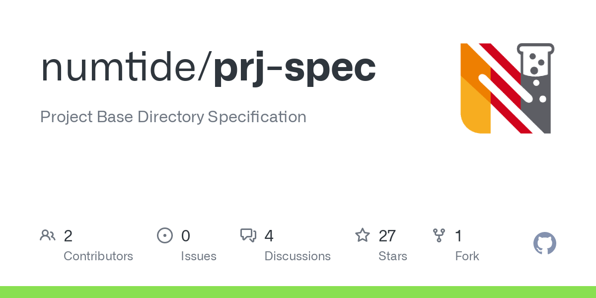

These aren’t mentioned in the spec. Are the norms being drafted (read: not documented) or is this just a preemptive effort (read: tacked on)?
These are tacked-on by analogy with the XDG.
However, PRJ_STATE_HOME has been removed as the distinction with PRJ_DATA_HOME was just too shallow.
A future iteration on the spec may or may not take them into account.
