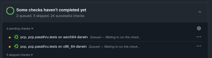

yeah, i mean, nixpkgs is hard. There are tones of broken packages. Would be great with unlimited resources and time, to constantly scan the repo, mark broken ones, and use some automation to create pull requests to fix them. Similarly, some LLM help on nixpkgs pull request reviews would be great also.
But it’s all a matter of priorities and resources. For example, is fixing broken packages more important than fixing broken runners? e.g. This PR stuck waiting for runners for >24 hours
