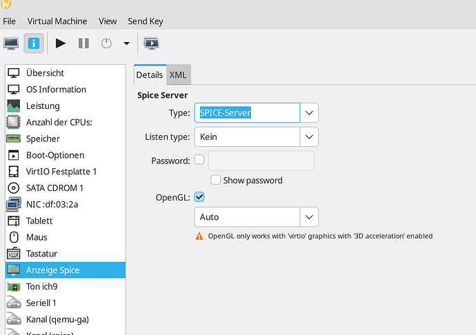

I had the same issue, until I enabled OpenGL in the Spice settings:
But keep in mind, sleep is not working for the guests with virtgl!
