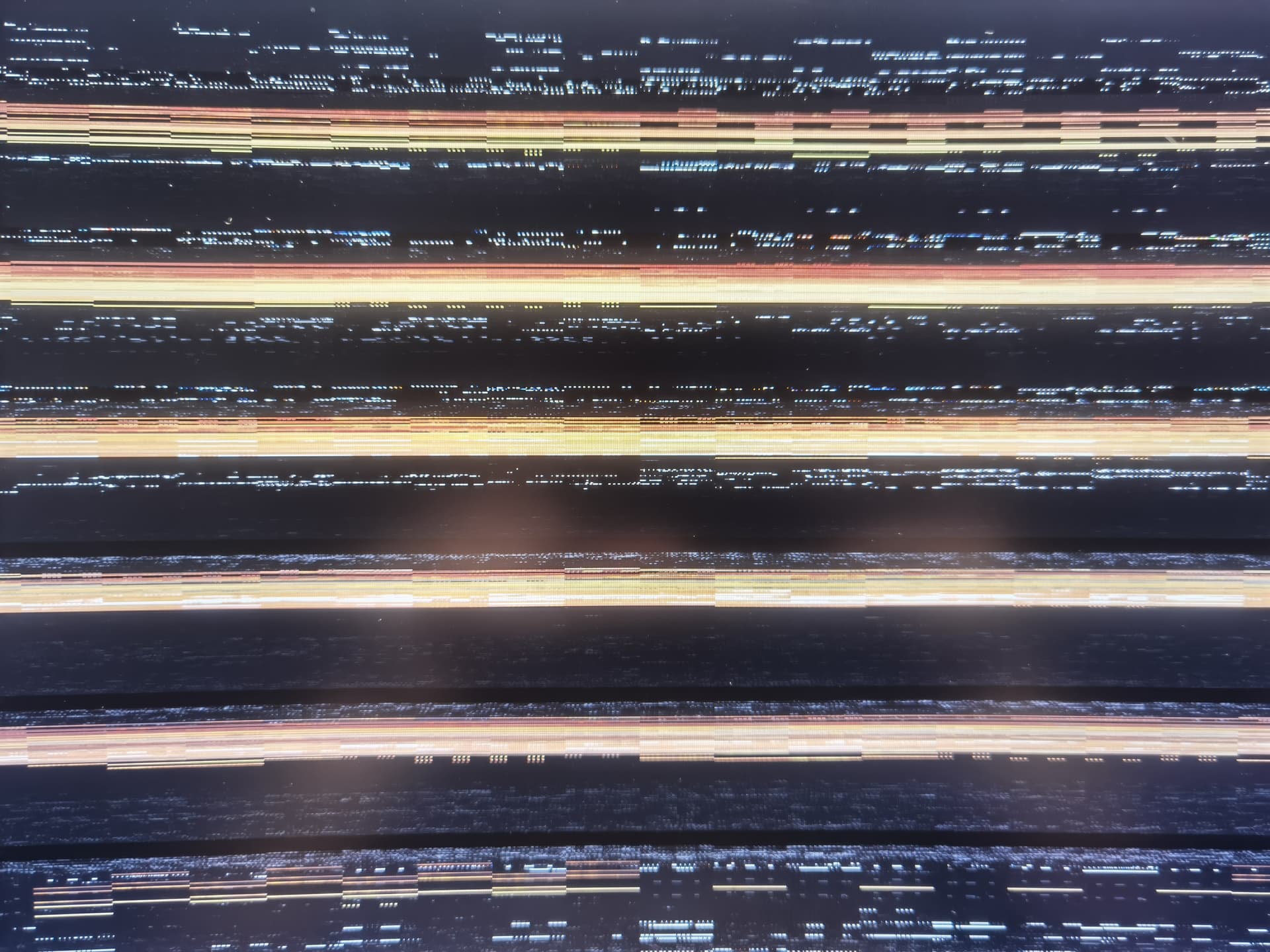

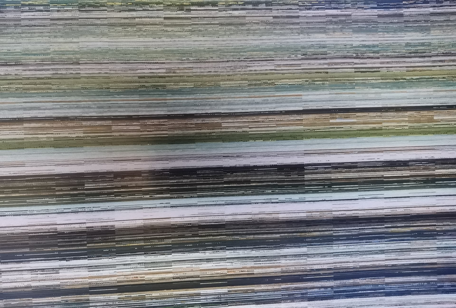

I’m experiencing persistent display issues with my AMD Radeon RX 6500 XT (4GB GDDR6) and other GPUs on NixOS 25.05 and would appreciate your expertise. Here are the technical details:
Hardware & Validation
GPU: AMD RX 6500 XT
Failure Modes (random occurrence):
Screen flickering
Transient black screens (then it died.)
Artifacts/corruption
Complete system freeze (requires hard reset)

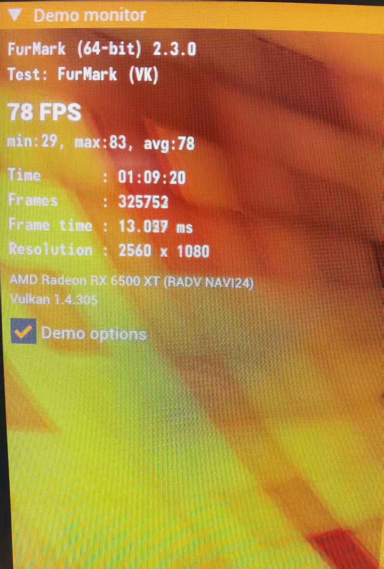

FurMark stress test: 1hr stable at 70°C (2560x1080) and it hadn’t crashed when testing
amdgpu_toprecognizes GPU correctly -
Vulkan/OpenCL workloads functional (Sometimes?)
