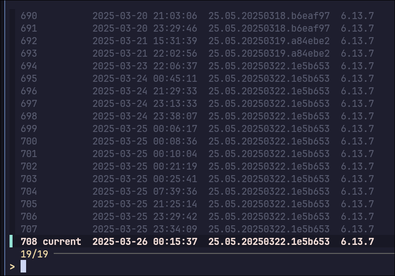

I came up with this helper script that uses fzf to show an interactive menu of the latest generations. Pick one and press enter to apply it, or ctrl-c to cancel.

Improved header management
#!/usr/bin/env nix-shell
#!nix-shell -i bash -p fzf
# shellcheck shell=bash
generation=$(nixos-rebuild list-generations | awk 'NR==1 { header=$0; next } 1' | fzf --header "$(nixos-rebuild list-generations | head -n1)" | awk '{print $1}')
if [ -z "$generation" ]; then
    echo "No generation selected"
    exit 1
fi
# if current generation is selected, do nothing
if [ "$(readlink /nix/var/nix/profiles/system)" = "system-$generation-link" ]; then
    echo "Selected generation is already active"
    exit 0
fi
sudo nix-env --switch-generation "$generation" -p /nix/var/nix/profiles/system
sudo /nix/var/nix/profiles/system/bin/switch-to-configuration switch
