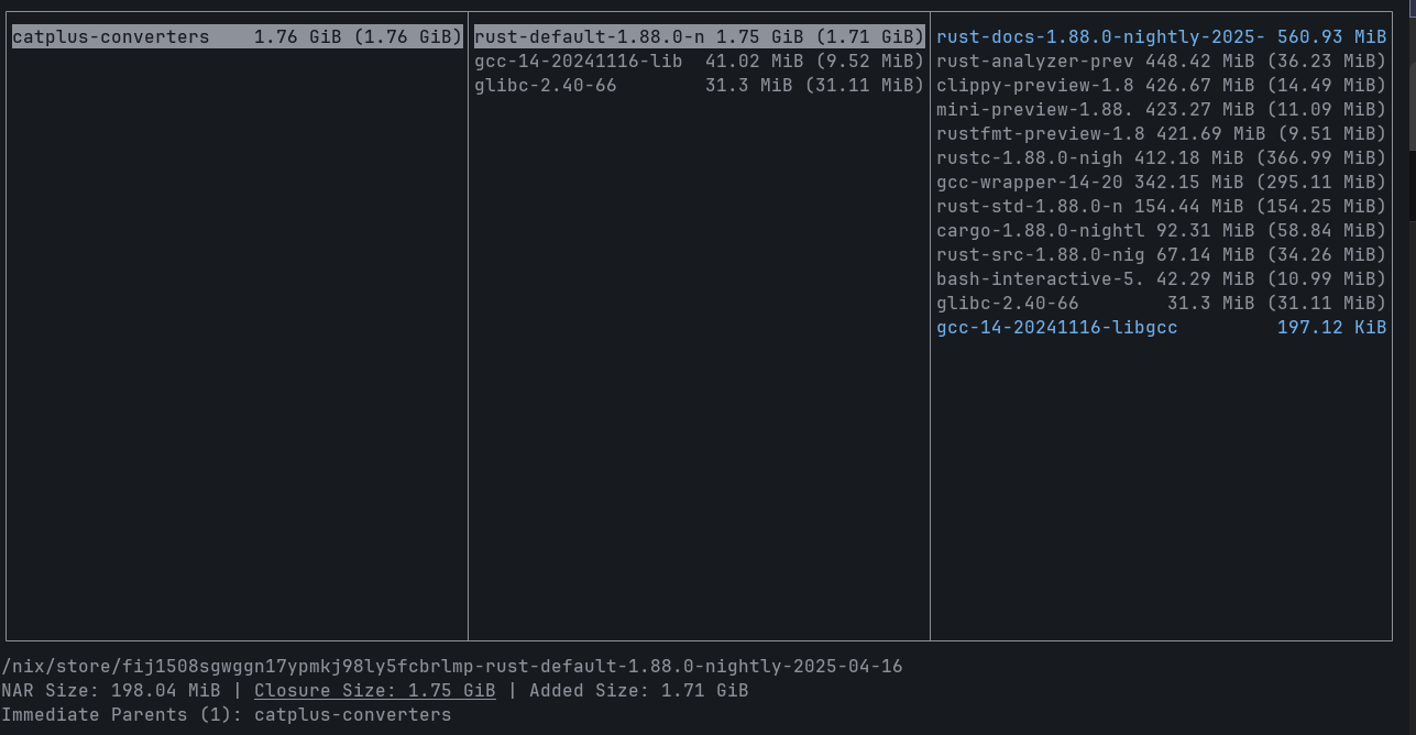

Problem
I have the following rust CLI tool default.nix which you can build with:
nix build "github:sdsc-ordes/catplus-converters?dir=tools/nix&ref=80025843a21e570ee86f6077360bffb07ae8f63d#catplus-converters" --print-out-paths
> /nix/store/pj638k9z33d5z125ainqhai16a79dax5-catplus-converters
I use the rust-overlay from oxalica:
# The Rust overlay to include the latest toolchain.
rust-overlay = {
url = "github:oxalica/rust-overlay";
inputs = {
nixpkgs.follows = "nixpkgs";
When I analyze this with nix-tree :
nix-tree /nix/store/pj638k9z33d5z125ainqhai16a79dax5-catplus-converters
I see a huge dependency which is the /nix/store/fij1508sgwggn17ypmkj98ly5fcbrlmp-rust-default-1.88.0-nightly-2025-04-16
of about 1. 75 GiB :
The ldd only reports the following deps:
ldd /nix/store/pj638k9z33d5z125ainqhai16a79dax5-catplus-converters/bin/converter
linux-vdso.so.1 (0x00007ffe5b57b000)
libc.so.6 => /nix/store/rmy663w9p7xb202rcln4jjzmvivznmz8-glibc-2.40-66/lib/libc.so.6 (0x00007f8858800000)
/nix/store/rmy663w9p7xb202rcln4jjzmvivznmz8-glibc-2.40-66/lib/ld-linux-x86-64.so.2 => /nix/store/rmy663w9p7xb202rcln4jjzmvivznmz8-glibc-2.40-66/lib64/ld-linux-x86-64.so.2 (0x00007f885919b000)
libgcc_s.so.1 => /nix/store/ik84lbv5jvjm1xxvdl8mhg52ry3xycvm-gcc-14-20241116-lib/lib/libgcc_s.so.1 (0x00007f885916b000)
Questions
Does anybody know why that happens cause these bloat dependencies seem to be build inputs only?? and what I can do to analyze that better, this is a fairly simple Rust app with some dependencies etc.
Does the rust-default somehow sneaks in by vendored dependencies?

Thanks for the references! I am just puzzled why rust-default even is part of the final derivation eventhough its not ? needed to run the application AFAIS… its just strange because these things seem to me like build dependencies…
rust-default comes from the oxalica/rust-overlay overlay you’re using or am I missing smth?

There is a missunderstanding here: Its all about the single $out/converter in the final derivation, which is a ELF executable and for which some how Nix thinks it needs /nix/store/...rust-default-... because thats what Nix found as runtime dependencies when have done the anaylysis after the build etc. (I suspect it does not do a simple strings analysis of the binary, right?).
The strange thing is using nightly-2024-06-17 instead of nightly will not have this behavior and the link to rust-default- store path is gone, so when using this

Ok, apparently the components = section now influences runtime-dependencies on newer toolchains (?).
So the solution is to make a toolchain.toml file for Nix building not use components etc.
