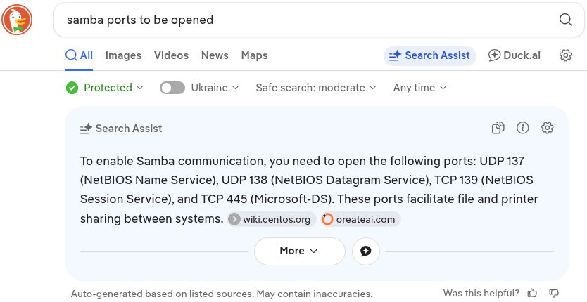

  2. i can’t remember RN but there is a setting in samba config that enable netbios name resolution and local master browser - 2 mandatory options I believe are turned on by default in NAS operating systems like XigmaNAS and OpenMediaVault to provide net discovey. I remember I could see those Unix/Linux servers easily from Windows and Fedora WS. So it’s not Avahi-related - SAMBA name resolution utilizes different protocols and requires several ports to be opened in the server’s firewall (have you done that?)
