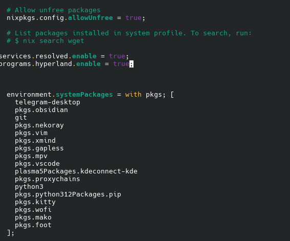

i really dont know where i shall start from. here, i installed pkgs.kitty.
but at that time, when i added ‘programs.hyperland.enable = true;’ i got an error:

i think im doing smth wrong but i don’t know what it is
It tells you what the problem is: the option does not exist. In this case you misspelled hyprland. It is written without an ‘e’.
Could you please edit your post and put the code in code ticks.
You spelled it wrong, it’s hyprland.
