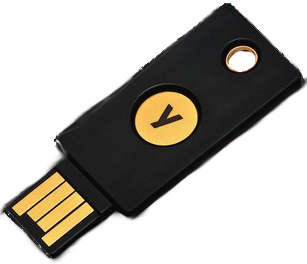

The issue with using a key on a USB stick is that it is easily copied. Maybe you want that, I don’t know, but normally a problem like this is solved with a Yubikey. There are some pointers to setting one up in the NixOS Wiki.

I used yubikey/ security key (SK) interchangibly - referring to U2F/ FIDO.
From reading, with the combo of
- pam_rssh GitHub - z4yx/pam_rssh: Remote sudo authenticated via ssh-agent
- yubikey-agent GitHub - FiloSottile/yubikey-agent: yubikey-agent is a seamless ssh-agent for YubiKeys.
One should be able to SSH into a machine and forward the sudo auth request to the security key of the SSH client machine
This blog-post also describes how to replace the password auth with a yubikey touch if a key is present, with fallback to password enabled. Something I personally consider mandatory behaviour in case my SK fails or gets lost
