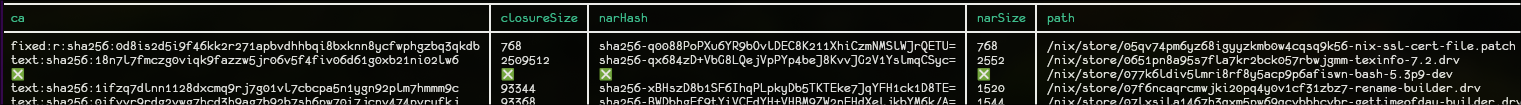

Also interesting, because that change just adding ?'s doesn’t work for me — the join fails because there are no paths.
But it gets more complicated. The random cppnix box I chose for the parts above is a little out of date: nix (Nix) 2.31.3
On another, with nix (Nix) 2.34.7 it emits a warning:
warning: '--json' without '--json-format' is deprecated; please specify '--json-format 1' or '--json-format 2'. This will become an error in a future release.
So, it seems there are versioned json formats after all. But even version 1 is the same as the ā€œnewā€ format above, version 2 adds an info object wrapper around it with versioning info. Fun.
Curiouser and curiouser.
Mine are all on lix, and have been updated enough times and mostly to the exact same versions that I’m confident it isn’t that.
Some weird dangling parts of the nix store would be more likely to me, ones that impacted all but one system for some odd reason. But I can’t find an easy way to extract out the rows that have the bad data :frowning:

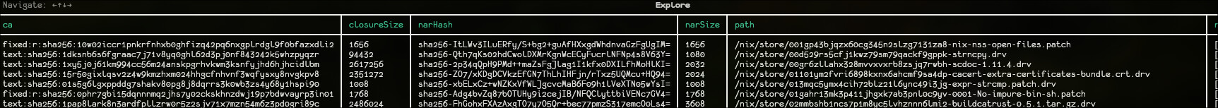

try (after setting roots as per the first pipeline):
let pathinfo = ^nix path-info --closure-size --json ...($roots | get path)
    | from json
    | where (is-empty closureSize) or (is-empty narSize) or (is-empty path)
and then look at the result with $pathinfo or $pathinfo | explore or $pathinfo | save debug.json
I’m confused which rows have the nulls… I don’t think that where works.
But explore does tell me some things:
Apparently I have paths that are empty…?

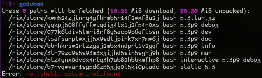

Why is that a path that needs to be fetched?
What is going on here?
not sure, but let’s take more detailed debugging to dm (or matrix)
