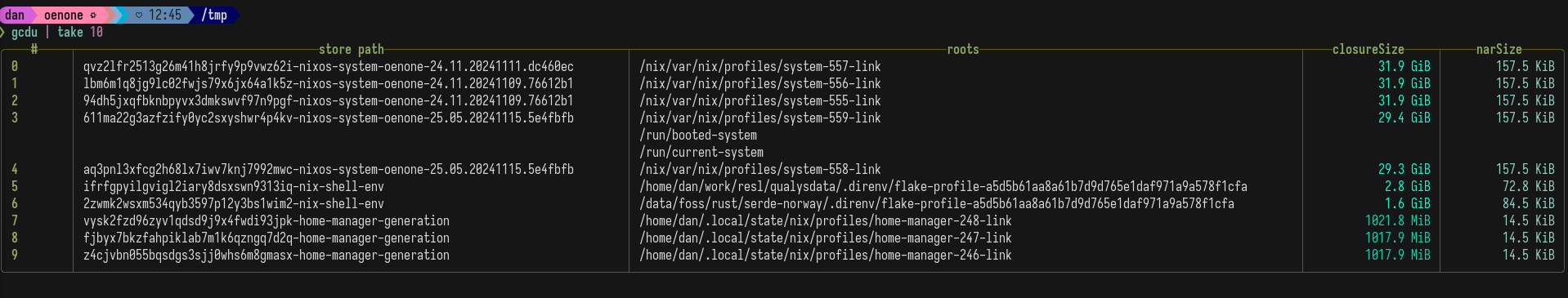

sample output, in md format (slightly modified because discourse’s md tables don’t do inner newlines)
❯ gcdu | take 10 | to md -p
store path roots closureSize narSize
qvz2lfr2513g26m41h8jrfy9p9vwz62i-nixos-system-oenone-24.11.20241111.dc460ec /nix/var/nix/profiles/system-557-link 31.9 GiB 157.5 KiB
lbm6m1q8jg9lc02fwjs79x6jx64a1k5z-nixos-system-oenone-24.11.20241109.76612b1 /nix/var/nix/profiles/system-556-link 31.9 GiB 157.5 KiB
94dh5jxqfbknbpyvx3dmkswvf97n9pgf-nixos-system-oenone-24.11.20241109.76612b1 /nix/var/nix/profiles/system-555-link 31.9 GiB 157.5 KiB
611ma22g3azfzify0yc2sxyshwr4p4kv-nixos-system-oenone-25.05.20241115.5e4fbfb /nix/var/nix/profiles/system-559-link
/run/booted-system
/run/current-system
29.4 GiB 157.5 KiB
aq3pnl3xfcg2h68lx7iwv7knj7992mwc-nixos-system-oenone-25.05.20241115.5e4fbfb /nix/var/nix/profiles/system-558-link 29.3 GiB 157.5 KiB
ifrfgpyilgvigl2iary8dsxswn9313iq-nix-shell-env /home/dan/work/resl/qualysdata/.direnv/flake-profile-a5d5b61aa8a61b7d9d765e1daf971a9a578f1cfa 2.8 GiB 72.8 KiB
2zwmk2wsxm534qyb3597p12y3bs1wim2-nix-shell-env /data/foss/rust/serde-norway/.direnv/flake-profile-a5d5b61aa8a61b7d9d765e1daf971a9a578f1cfa 1.6 GiB 84.5 KiB
vysk2fzd96zyv1qdsd9j9x4fwdi93jpk-home-manager-generation /home/dan/.local/state/nix/profiles/home-manager-248-link 1021.8 MiB 14.5 KiB
fjbyx7bkzfahpiklab7m1k6qzngq7d2q-home-manager-generation /home/dan/.local/state/nix/profiles/home-manager-247-link 1017.9 MiB 14.5 KiB
z4cjvbn055bqsdgs3sjj0whs6m8gmasx-home-manager-generation /home/dan/.local/state/nix/profiles/home-manager-246-link 1017.9 MiB 14.5 KiB
