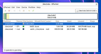

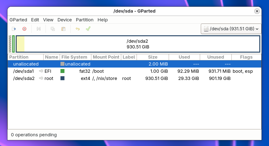

Do you have any idea about this ‘/’ root?
As I see it, there are two root /,/ on /dev/sda2 and an unallocated part at the beginning of the disk, does anyone have an idea what happened to my installation?
I do not understand what you mean by “there are 2 root on /dev/sda2”.
I only see a single one.
The device /dev/sda2 is currently mounted 2 times, once at / and once at /nix/store, the latter very likely being a read-only bind mount to itself.
I think there is another explanation for the problem, there is an unallocated part on the hdd 2.2 mb before efi boot, which I find with gparted via a live boot

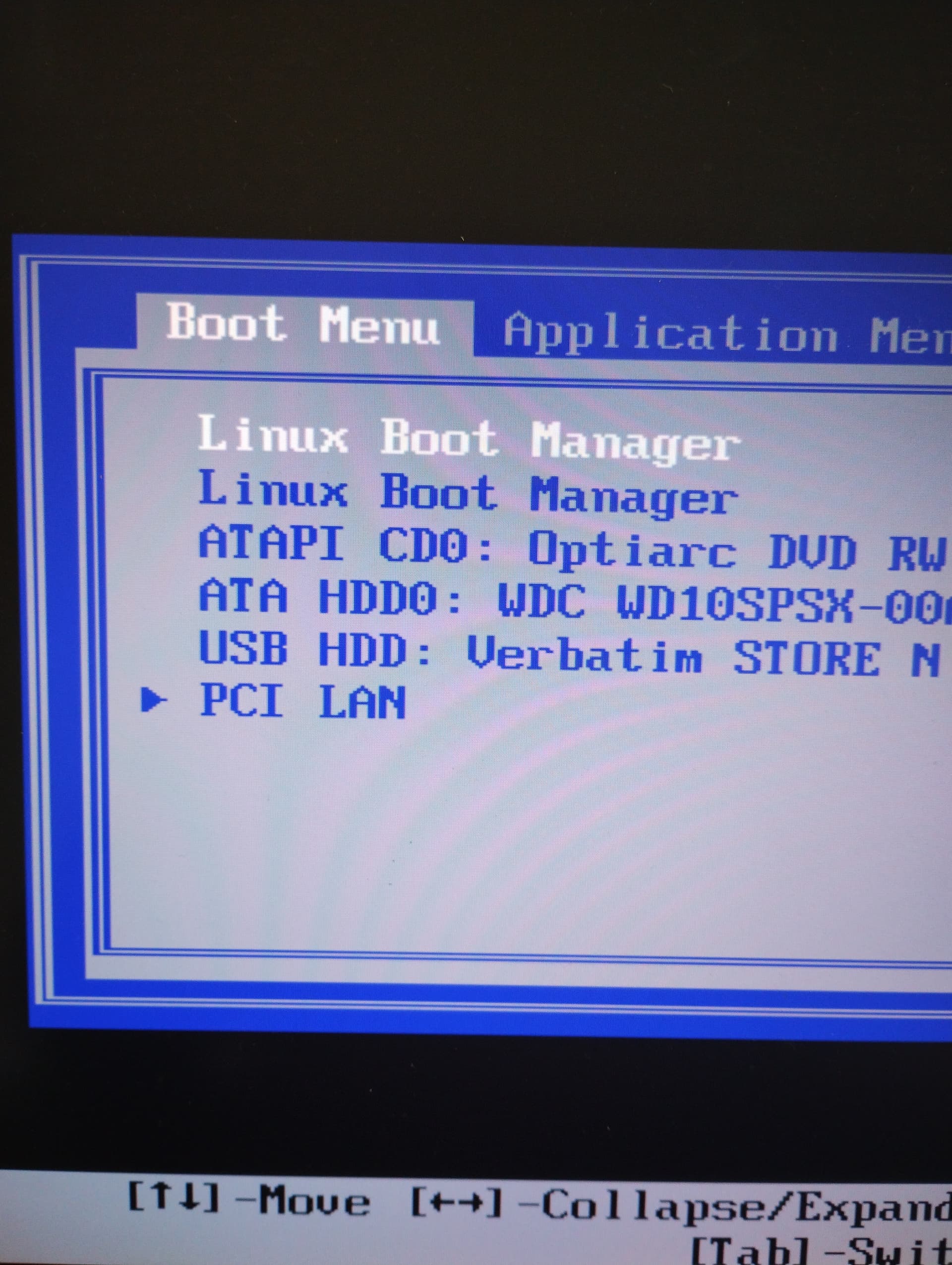

in the boot menu I can see that there are two boot options ‘Linux boot manager’ but only one works, can I remove the old one and how?
I don’t understand what you mean, when I look at the output of ‘lsblk’ it seems to be an extra ‘/’ below ‘/dev/sda2’
why is dev/‘sda2’ mounting twice
There is no “extra” /, there is only one. And it is mounted twice because your config does contain instructions to mount the blockdevice itself as /, while also is configured to remount /nix/store read only. The latter is the default on NixOS. And at least on a quick search, I am unable to find the option that controlls this behaviour. I am under the impression that this was optional in the past, though it seems as if it is mandatory now.

and the boot problem is solved by ‘efibootmgr -b xxxx -B’
