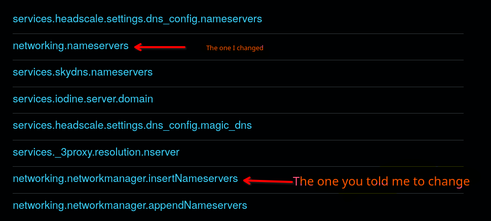

Here’s what I did:
I woke up, ran sudo resolvectl flush-caches, added networking.networkmanager.insertNameservers = [ "1.1.1.1" "8.8.8.8"]; and boom, it somehow started working. It was probably one of these two changes that did the trick, since last night I am sure it wasn’t working and if I boot into the live iso it doesn’t work anymore. However, I can’t really test which, since it is impossible to run sudo nixos-rebuild switch on the live iso without getting an error, as far as I have tested. and especially because even if I remove the line I added to the configuration.nix it doesn’t stop working… I can’t make it stop working now!
I would just like to add that, in order to not look as stupid as I might look now since the second change was easily findable online, it appears I enabled the wrong option when I tried to do that…
and it apparently didn’t work. Though I only used the 8.8.8.8 one at that time, which could have had something to do with it, maybe? Regardless, I thank you very much for the time you took to answer this issue, and for the extremely helpful tips.
Cheers!
PS: I deleted my last post because I discovered you had to enable a setting to use resolvectl right after posting it, and went to sleep before testing anything. I apologize for that
You shouldn’t feel bad; networking gets complicated fast as soon as you stray from the default path. I’ve been doing network configuration for many years, and I still need to lookup details for just about everything. My experience just helps me know where to look and how to place things in context.
For instance, I do not recall if NetworkManager tries DNS servers one at a time (in order) or in parallel. The existence of before and after config implies that it does lookups serially, which makes insertNameservers the better option for your use case.
networking.nameservers is not a NetworkManager option. I’d have to dig deeper to understand how it interacts with NetworkManager and if it is compatible. It could be a way to remove your ISP DNS from the list, but this could cause problems when you connect to captive-portal network such as a cafe wifi.
There are many public nameservers you could use. CloudFlare, 1.1.1.1, and Google, 8.8.8.8, are just two. But listing more than you need could make diagnosing future problems more difficult.
Having services.resolved working is great. It means your system will look for a cached DNS answer before going to the network. This should save some time with repeat connections to Internet hosts – especially if your ISP network is slow.
Welcome to the world of nixos. The journey can be hard at times, but it is well worth it for what we learn along the way and for the results we get. :slight_smile:
