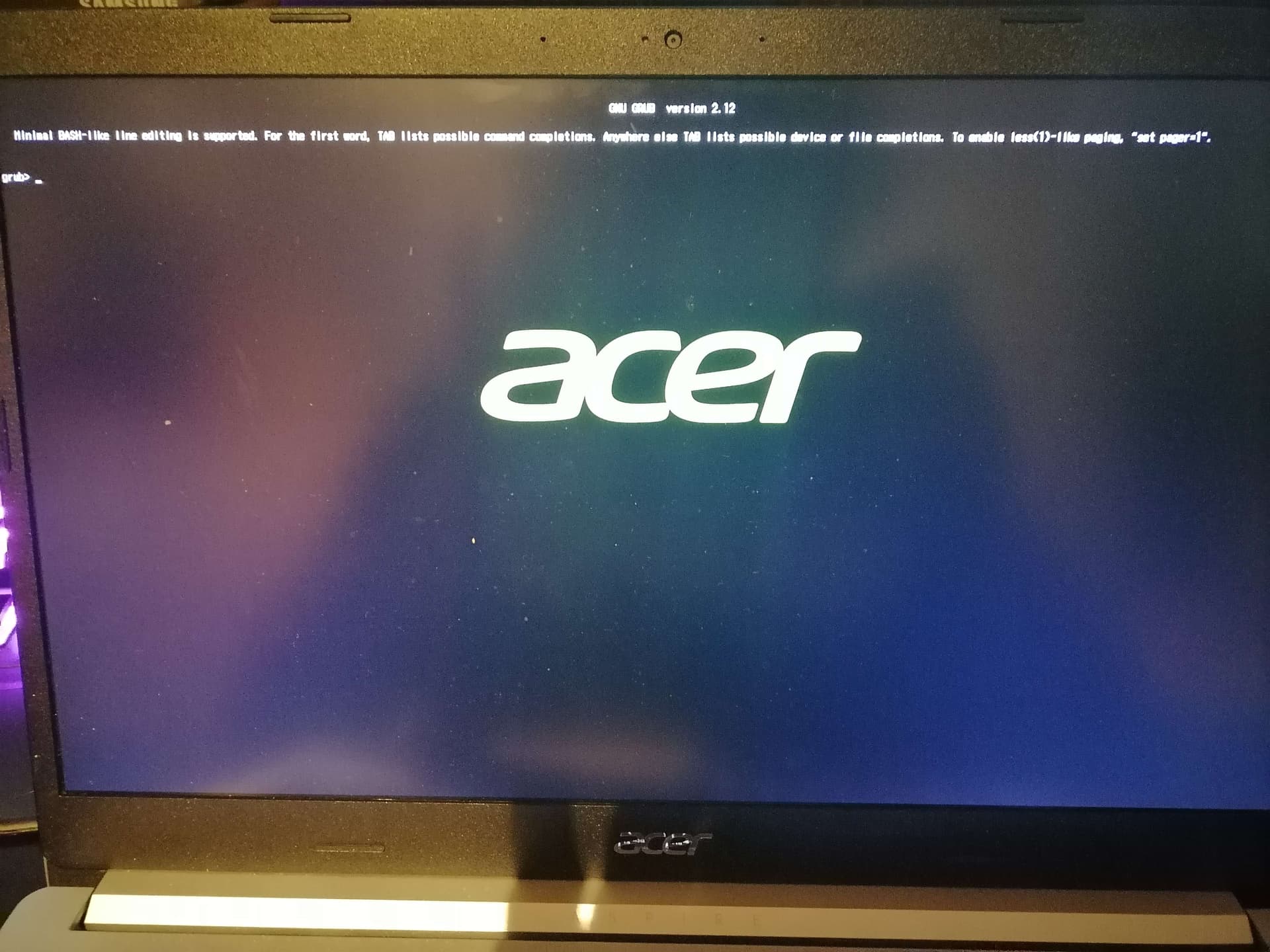

Hello, I just changed my default shell from zsh to fish, and rebuild my nixos configuration. I don’t think that is the cause, but it was the last thing I did before this problem. After rebooting, I am instantly stuck in the grub-cli, and can’t even rollback anymore because of that.

I doubt a change in userland would affect the bootloader, are you sure you are being thrown into the GRUB rescue shell and not the system recovery mode?
Like I said, I also don’t think it has anything todo with fish, I never encountered the GRUB rescue shell or the system recovery mode before, so I can’t say wich of the two is it, but since it says GRUB I would guess it is the GRUB rescue shell, here is a picture:
