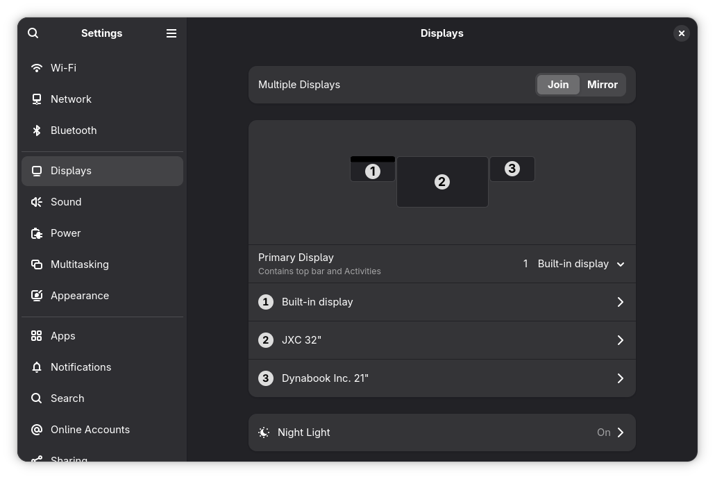

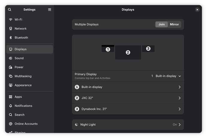

Back on NixOS. Here’s the dmesg output. Here is the GNOME display settings dialog:
If I plug a display directly into the laptop HDMI, it is detected and used. But with the above configuration, with the displays plugged into the docking station, they are detected but not used. One of the displays shows its own No input message and the other displays nothing and is on standby. From experience, I know that it comes off standby when it detects and input.
