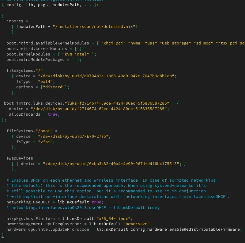

Heres my configuration.nix and hardware-configuration.nix respectively. For both swap and root I have allowed discard:
You can try to set allow-discards in the LUKS2 header: encryption - Disable allow-discards on encrypted partition - Unix & Linux Stack Exchange
Thank you for your reply, this indeed solved the problem but this is quite a strange behavious becase I had already allowed discard on the the phyiscal sda2 drive so why do i still need to persist it on the mapped luks2. Also this feature is only available on Luks2, had to covert from Luks1 to Luks2. Also I have a laptop running nixos on the internal SSD with the same configs and allowing discard on the physical volume level sufficed and TRIM was working normally, didnt have to do these additional steps. Seems this behaviour is unique to external SSDs
