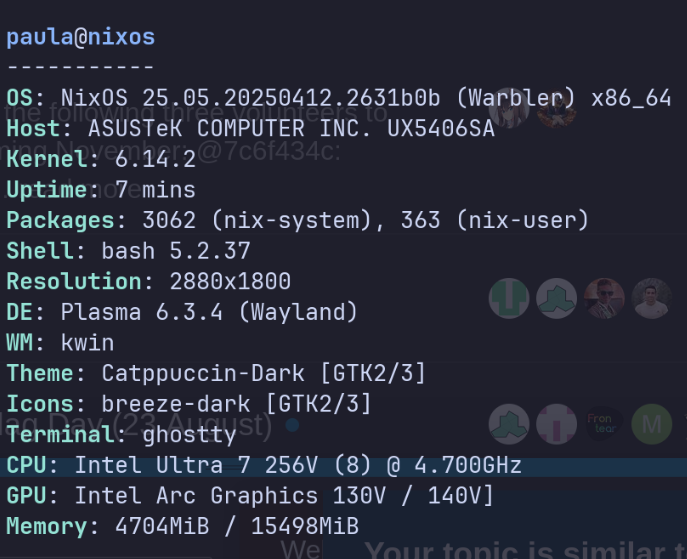

Hi there, i’m trying to install linux most recent kernel (6.16.6), and followed various steps, and everytime i cannot install this kernel, only updating until 6.14.2…
I’ve followed these steps Linux kernel - NixOS Wiki but my version is still stuck on 6.14.2
What could i do to make this option avaible, because I’m using 256v, and the battery quality is poor in versions below 6.16

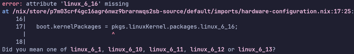

To use the 6.16 kernel, add to your configuration:
{ pkgs, ... }: {
  boot.kernelPackages = pkgs.linuxKernel.packages.linux_6_16;
Afterwards, use nixos-rebuild boot and then reboot.
For me the issue here sounds like a problem in your update steps.
Both stable and unstable channels should have a 6_16 kernel.
Are you using channels or flakes (or which other method to pull nixpkgs?)
And what are the commands that you are running to update your system?

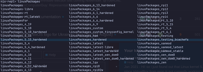

Hi there, there ain’t a argument for that, the arguments that my system links are in the 1st image, and IDK why, because isnt supposed to apear 6.16 there?

Yep, that definitely is the problem. To actually update your system, you need to run nix flake updae in the directory with the flake.lock / flake.nix file before rebuilding. It will update the references in flake.lock, which you should commit. Without that you’re stuck at whatever is in flake.lock.
You are not using 25.05, just unstable (the OS string just gives you whatever unstable would become at the time), but you haven’t actually updated in 3 months; I guess you last updated before the 25.05 branch-off, when 24.11 was still stable. You probably should get to that.

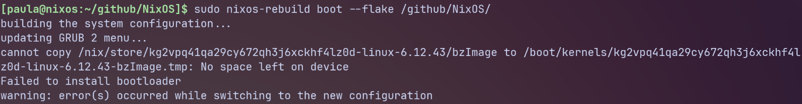

Hi there, sorry for the delay I’ve switched it all up as you mentioned, but now i cant upgrade to newer versions,(btw I reinstalled the system)

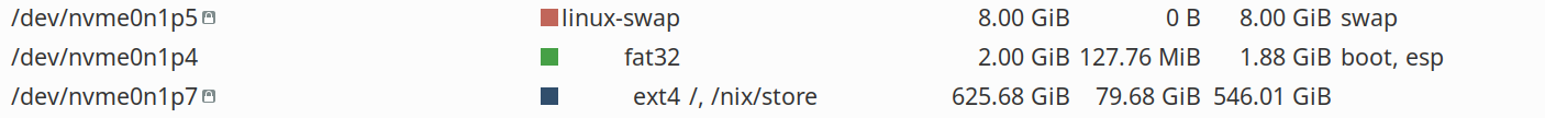

ps: i dont think is a lack of space
It is a lack of disk space, in your boot partition. NixOS creates a separate boot entry (which means a separate kernel + initrd) for every build.
If you don’t set your boot loader’s configurationLimit, this means that it will just keep creating more until your boot partition is full.
The kernel + initrd isn’t huge, but they’re in the order of tens of MB. With a 2GB boot partition you should be able to fit about 100 or so.
This means, either of these things happened:
  • You didn’t set configurationLimit and finally hit 100 generations
  • You reinstalled and the new NixOS doesn’t know to clean up the old installations’ generations
    • I must admit I don’t know off the top of my head how the nixos-rebuild script recognizes which kernel/initrd pairs are stale
  • You configured your initrd in such a way that it takes much more than tens of MB to store
  • You’re multi-booting and your other operating systems take up a lot of space
You’ll have to share your configuration and tell us what is in /boot (recursively) if you want full instructions on how to fix it. But in a nutshell, something in /boot needs to be deleted before you can create a new generation.
See also the headings on removing and limiting old generations here: Bootloader - NixOS Wiki
It was a grub config, thanks a lot for the help
